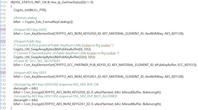

Here is my test flow,
1. Import AES Key 0
2. Import Public Key(Curve ID : ECC_SEC_SECP256R1)
3. Import AES Key 1
4. Use AES Key 0 & 1 to encrypt test pattern
AES Key 0 encrypt service response HSE_SRV_RSP_OK
AES Key 1 encrypt service response HSE_SRV_RSP_NOT_ALLOWED

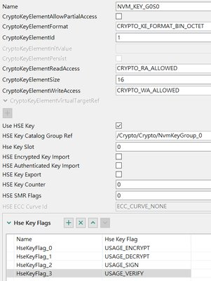

AES Key 0 & 1 use same keyelement setting
Looks like point is 'import ecc pub key', but I'm not sure why this happended?
And I switch import timing of these AES keys, result is same.
Encrypt service by the AES key(witch is import after ecc pub key)will response HSE_SRV_RSP_NOT_ALLOWED.
