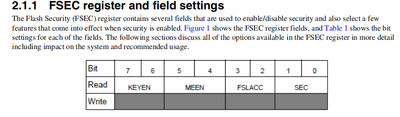

i configure FSEC register by follow figure:

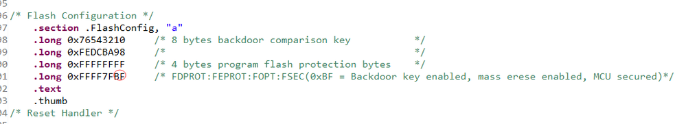

example code as follow:
inside,

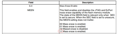

mass erase enable, now, chip is secure. but now,

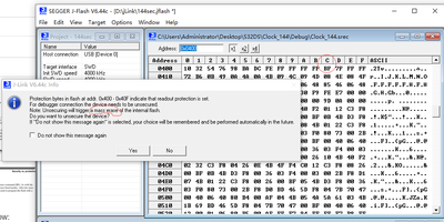

mass erase not disable security. option as follow:
button yes, not disable security.
unlock kinetis commander also disable security.
please tell me why? Thanks

Hi lyz,
Have you tried the new version of J-Flash software? Did you select allow security when chose device?
Mass erase should be able to unsecure the chip.
Please read the value of MDM-AP status and control registers by refer to:https://community.nxp.com/t5/S32K/Unbricking-S32K146/m-p/937227
Please input connect command first.
You can also try program the chip after mass erase using the loadbin command.
