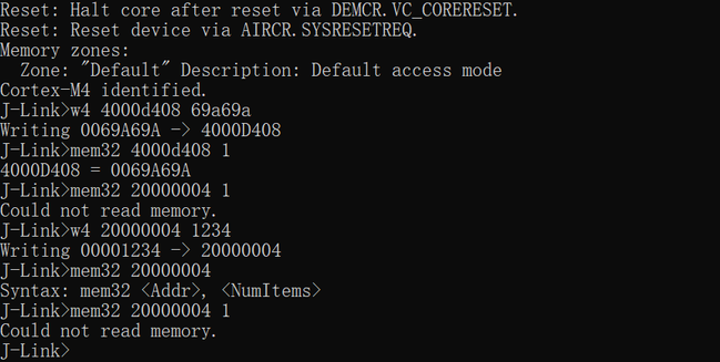

Senlent
Hi@Ccccc
below is my test process, I see no problem here.
5,118 Views
Ccccc
Your steps has a little different from mine, please follow the following steps to reproduce the problem, thans.

Ccccc
Hi Senlent,
Before configuring 0x4000d408 as 0x69a69a, the default permissions are read, write, and execut.
Your steps has a little different from mine.
First, perform the write operation on 0x20000004  (as step1),then perform all the steps in your screenshot again.
Please refer to my previous reply,even if configured as read-only (step2 and step 3), the value of 0x2000-0004 can still be read out (as step4)
