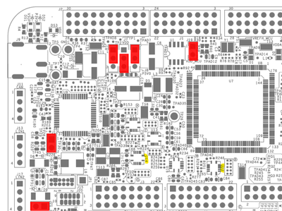

  • The S32K148-Q176 board uses TXB0104 bi-directional level shifters between the MCU and the PHY. These can affect signal shape and timing. Please verify their correct operation, as they may be responsible for the ringing or distortion observed on PTB4.

As for the TXB0104 bi-directional level shifters Im not sure how I can test those, or even where they are found on the board itself. Could you guide me on doing that? Also the board is quite new so I highly doubt it is broken, unless it is defective.

Regarding the level shifters for MDIO and MDC signals, please refer to the attached image for the location of U14 (MDIO) and U22 (MDC) on the board (the yellow ones). You can probe their behavior using an oscilloscope to verify signal integrity. I agree that if the board is new, the likelihood of damage is low, unless there is a manufacturing defect.

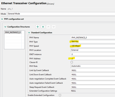

To validate the behavior, I ran the lwip_s32k148 example on the S32K148EVB-Q176 board using the following setup:
Software:
  • S32 Design Studio v3.5
  • SDK: s32sdk_s32k1xx_rtm_401
Hardware:
  • TJA1103-SDBR daughter board in rev-RMII mode
  • PHY address: 0x02
  • No pull-up resistor on MDIO line
I added a PHY driver and defined the PHY entry.
A FreeRTOS task was created to blink an LED and periodically read two PHY registers using PHY_Read(). I kept the MSCR settings at default, resulting in:
  • MDC frequency: ~2.39 MHz
  • Hold time: 20 ns (MSCR.HOLDTIME = 0x0)
  • Hold time: 170 ns (MSCR.HOLDTIME = 0x7 - set by debugger)
I tried resetting the PHY, but it turned out to be unnecessary — so I commented out the related code.

I'm not able to review your entire code (but thank you for sharing it anyway). However, please note that the first parameter of PHY_Read (as well as other PHY functions) is not the PHY address, but the index of the PHY entry — so it should be 0 or PHY_INSTANCE_0. The PHY address must be set within the PHY entry itself.
