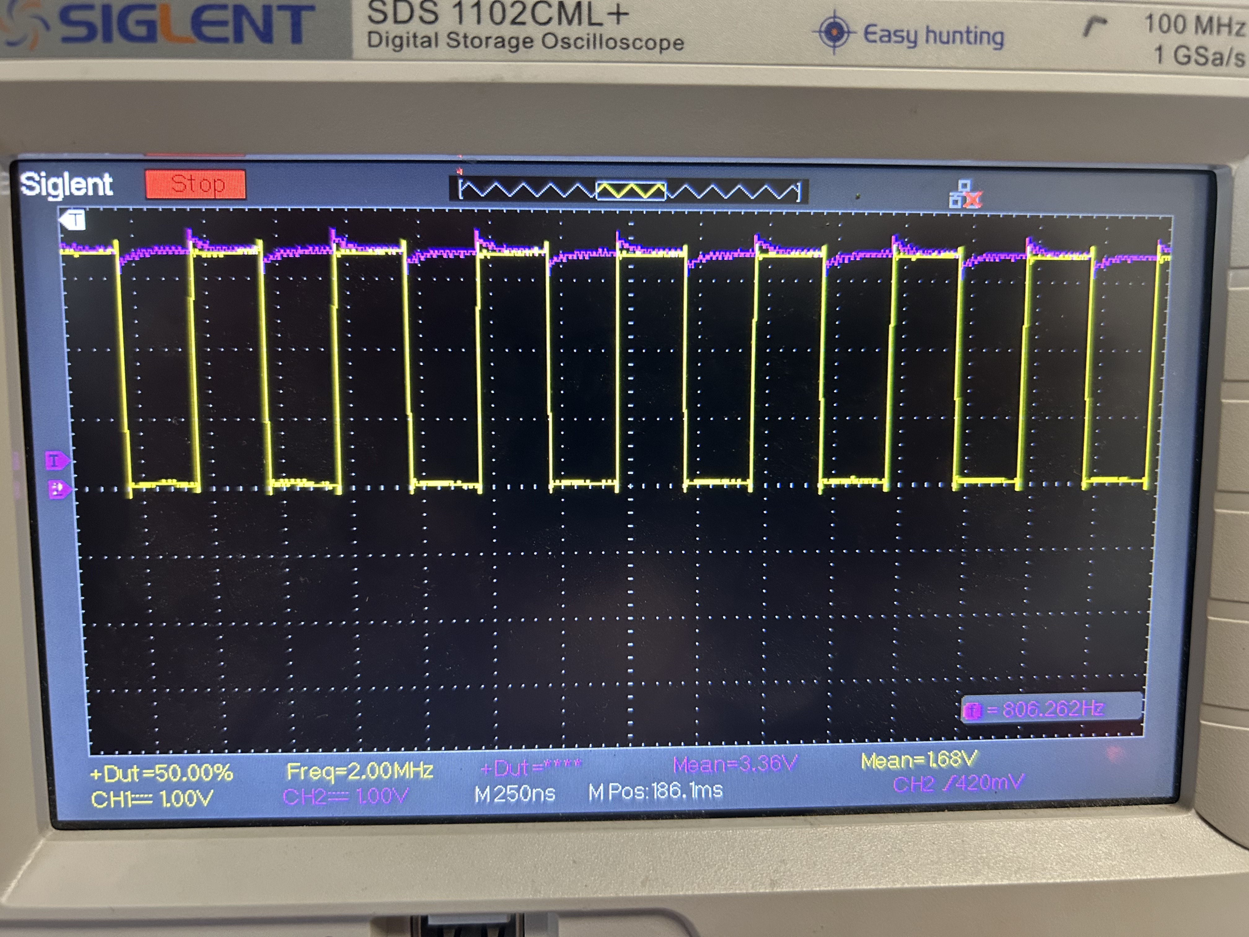

christopherlajoie
Update on the situation, I found out the I did not mux the right pin for MDC, and after changing it the MDC signal is perfect at 2MHz. However, I still have issues with MDIO stability. The Mac is able to read from the phy but the link stability is awful. Ive attached some picture of MDIO reading from my oscilloscope. Ive come to understand that pin PTB4 which is MII_RMII_MDIO should be an open-drain in order to let both the MAC and the phy write to it. However I dont see that option inside the pin muxing menu and its locked as an input/output pin. I get the impression that the phy and the mac are fighting for it for some reason. also the signal around the 3.3V on the pictures looks like discharge/charge curves.

christopherlajoie
Here are some more pictures of both signals together

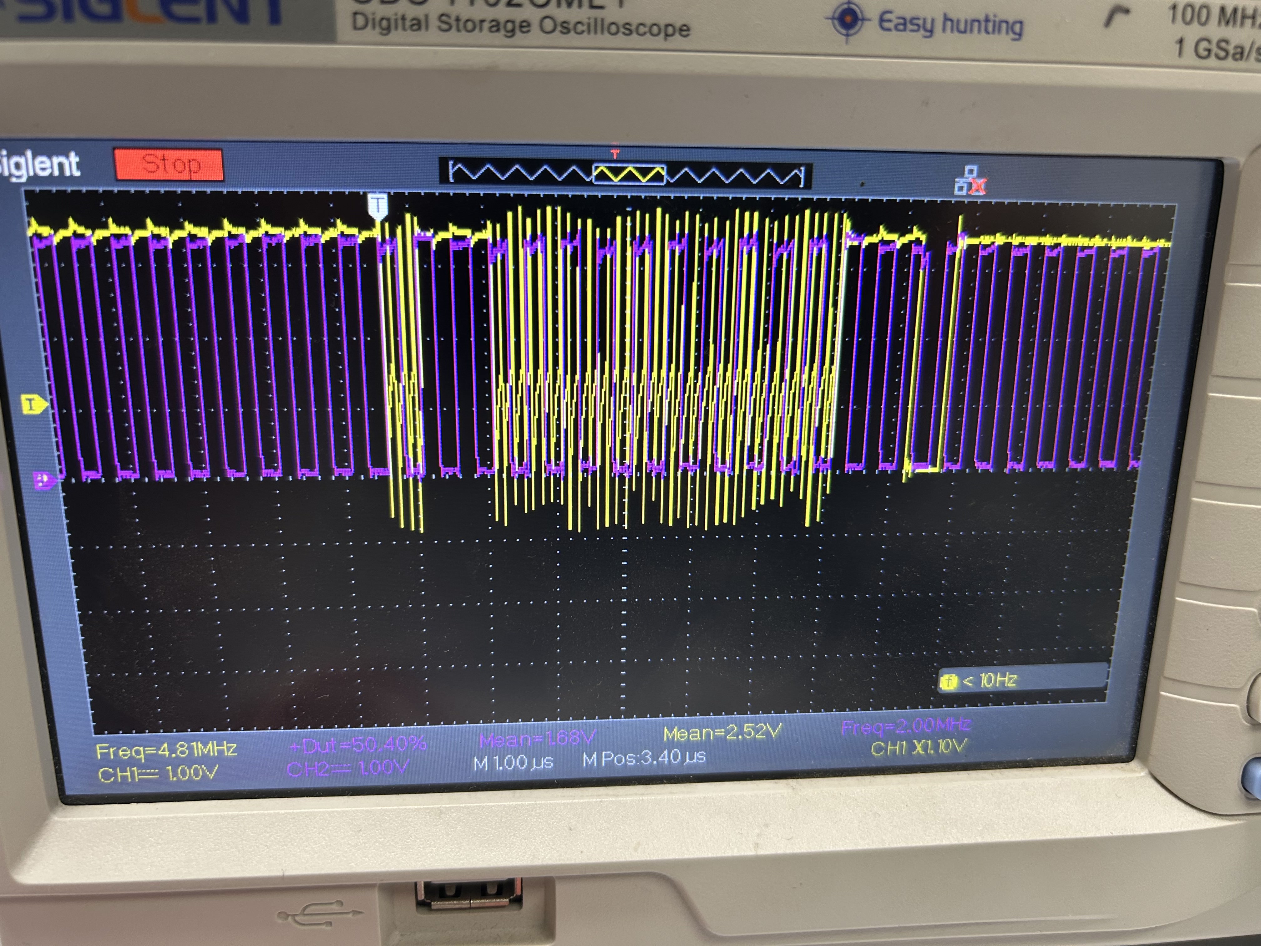

christopherlajoie
Hi PaveIL,
Thanks a lot for your input, you are right about the undersampling I was indeed not reading the signal correctly. I've sampled it properly and here are my findings:
- On every PHY_read() transaction it seems the MAC writing on the MDIO bus part of the signal is all over the place, but the PHY writing on the bus looks clean.
- From the pictures I linked it seems that the MAC isnt properly able to pull the line low to send logic 0's and that results in very sharp spikes between 0V and 3.3V during the entire write duration.
- The timing of the writes seem fine from what I could see.
I looked into it and Im wondering if its not an issue with the MDIO/PTB4 pin of the J16 connector. I've got it configured properly as you can see below but it doesnt seem to behave as an open-drain collector. Am I missing some configuration?
Ive modified the config to set MDC frequency to 1 MHz which is why its reading 1 MHz on the pictures. Also the hold time is set to 3 module clock cycles at 48MHz.
Thanks!

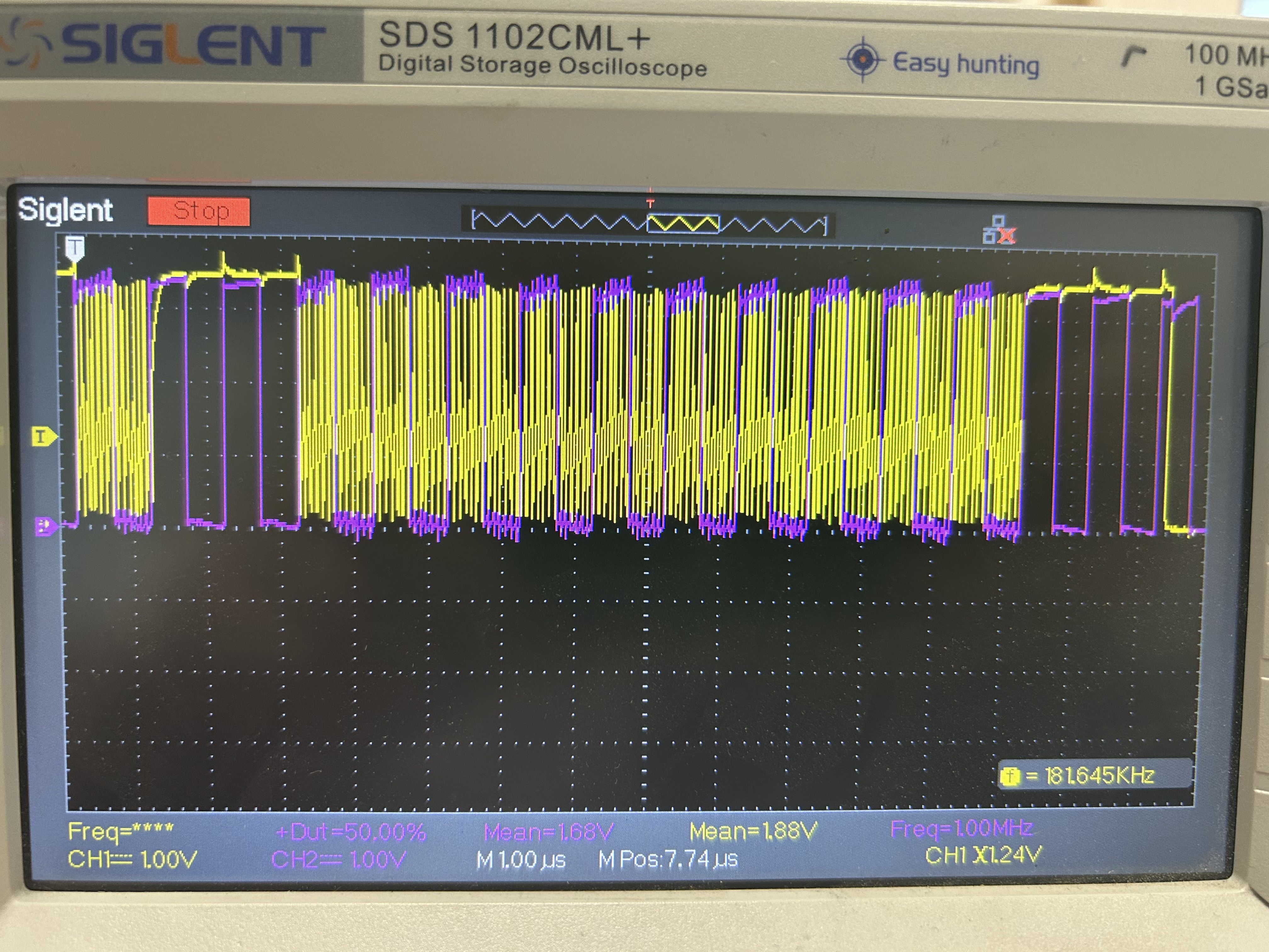

christopherlajoie
Also, I've measured the MDIO signal right on R46 resistor to make sure that the issue wasnt with my PCB and I got the exact same signal, with some noise since I couldnt find a GND spot close enough to the resistor. See the picture below
22,789件の閲覧回数
christopherlajoie
It seems I might have been wrong, I just measured the signal on the MDIO line without my PCB plugged in (no phy) meaning that nothing would answer the read request of the MCU and the signal actually looks clean! And it has the same overall form has the bad signal which would mean the phy interaction with the MCU on the MDIO line somehow corrupts the signal of the MCU. See image below
22,787件の閲覧回数

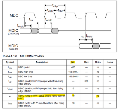

christopherlajoie
Another thing is in the LAN8720A datasheet, in table 5-12 its written that MDIO signal setup time for data-in in reference to the rising edge of MDC should be at least 10 ns. However, I've measured the signal on the unpowered board with unplugged phy and their seem to be no setup time at all. Is it a parameter I forgot to set? I did set hold time but not setup time. See picture below

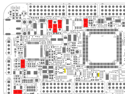

As for the TXB0104 bi-directional level shifters Im not sure how I can test those, or even where they are found on the board itself. Could you guide me on doing that? Also the board is quite new so I highly doubt it is broken, unless it is defective.
Do you have an input for the setup time question I had? I find it very odd that the MDIO signal doesnt trigger at least 10 ns before the rising edge of MDC as shown in my pictures. Ive set the holdtime parameter to 1 cycle which in my case at 48 MHz equals around 20 ns. It is clearly detailed in the datasheet that setup time must be at least 10 ns. I test for both read and write operation to the phy and neither show a setup time.

christopherlajoie
I soldered a 10k ohm resistor in the place of the 1.5k ohm that was on the LAN8720A and it seems way to strong, pulling the entire 3.3V line down to around 1.5V. It breaks the whole signal so that is not a solution. I will try with different other values between 1.5k and 10k when I receive my digi-key order. Please note that I will be on vacation all of next week so I wont be able to follow-up with more debugging. I will be back on monday the 4th of august (EST time)

Regarding the level shifters for MDIO and MDC signals, please refer to the attached image for the location of U14 (MDIO) and U22 (MDC) on the board (the yellow ones). You can probe their behavior using an oscilloscope to verify signal integrity. I agree that if the board is new, the likelihood of damage is low, unless there is a manufacturing defect.
As for your question about the setup time: on the SMI interface, MDIO is sampled on the next rising edge of MDC. This means that the setup time requirement applies to the data being valid before that edge, not necessarily before the current edge shown in your capture. So the setup time requirement shall be met easily.

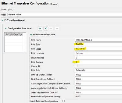

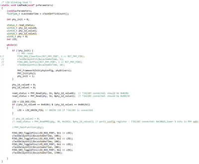

To validate the behavior, I ran the lwip_s32k148 example on the S32K148EVB-Q176 board using the following setup:
Software:
  • S32 Design Studio v3.5
  • SDK: s32sdk_s32k1xx_rtm_401
Hardware:
  • TJA1103-SDBR daughter board in rev-RMII mode
  • PHY address: 0x02
  • No pull-up resistor on MDIO line
added a PHY driver and defined the PHY entry.
A FreeRTOS task was created to blink an LED and periodically read two PHY registers using PHY_Read(). I kept the MSCR settings at default, resulting in:
  • MDC frequency: ~2.39 MHz
  • Hold time: 20 ns (MSCR.HOLDTIME = 0x0)
  • Hold time: 170 ns (MSCR.HOLDTIME = 0x7 - set by debugger)
I tried resetting the PHY, but it turned out to be unnecessary — so I commented out the related code.
Signals were observed on resistors R46 (MDIO) and R38 (MDC). Below is a waveform capture of a complete Clause 22 read transaction:
  • Target PHY: 0x02
  • Read register: 0x03
  • Data returned by TJA1103: 0xB013 (between cursors)
Please try to capture a full Clause 22 transaction on your oscilloscope for comparison. The waveform should resemble the timing diagram described on Management Data Input/Output - Wikipedia
I'm not able to review your entire code (but thank you for sharing it anyway). However, please note that the first parameter of PHY_Read (as well as other PHY functions) is not the PHY address, but the index of the PHY entry — so it should be 0 or PHY_INSTANCE_0. The PHY address must be set within the PHY entry itself.
