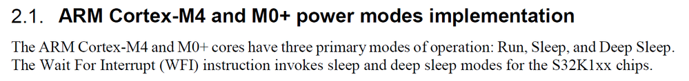

riccardolalli
Hi, Thanks for the answer.
No, sorry,  I noticed that the FTM is required in my application and can't be stopped, so STOP2 is not applicable.
However from the application note AN5425, I understand that ARM Sleep mode is indeed available on the S32K (paragraph 2.1), but the document does not say what are the effects on other peripherals. Are they affected if I put the Core in Sleep?
I would like a clarification on that, please.

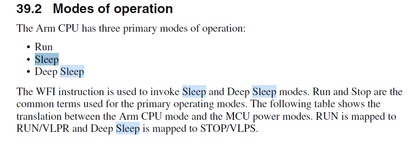

riccardolalli
Hello Diana,
If so then application note is incorrect, see paragraph 2.1
pastedImage_1.pngThe reference manual too say something about it
even if it doesn't explain much more. I think the reference manual is not very clear about this.
Also where in the manual can I find a definition of Wait mode and its association with ARM sleep?
Riccardo

dianabatrlova
Hello Riccardo,
It isn't very clear as you said. I will report to the apps team that "sleep mode" should be clearly described in the RM.
We can see the translation between ARM CPU mode and MCU power modes in section 39.2 Modes of operation. So, sleep mode is not there.
Also, the filed which represent sleep/wait power mode on the S32K1xx is empty in the AN5425 in Figure 1. Power modes comparison.
Diana

dianabatrlova
Hello Riccardo,
At first, I would like to mention a few points from RM rev. 11.
Also, please, look at the section 38.8 Module operation in available power modes, 39.2 Modes of operation and Table 39-1. Power modes
Deep Sleep is mapped to STOP/VLPS.
39.4.2.1 VLPS/Stop mode entry sequence
Entry into a low-power stop mode (Stop, VLPS) is initiated by a CPU executing the WFI
instruction. After the instruction is executed, the following sequence occurs:
27.4.4 VLPR/VLPS mode entry
When entering VLPR/VLPS mode, the system clock should be SIRC. The FIRC, SOSC,
and SPLL must be disabled by software in RUN mode before making any mode
transition. Ensure that CMU is gated by its PCC.CGC before entering STOP/VLPS/CPO
mode.
PMC_REGSC[BIASEN] must be set to 1 when using VLP* modes.
Diana
