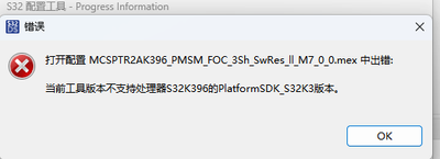

Hello, I purchased the MCSPTR2AK396 kit and encountered the following issue while running the demo:
I apologize for presenting this error in Chinese. I will translate the issue for you "Error opening configuration MCSPTR2AK396_PMSM_FOC_3Sh_SwRes_ll_M7_0_0.mex:The current tool version does not support the Platform SDK S32K3 version for processor S32K396."

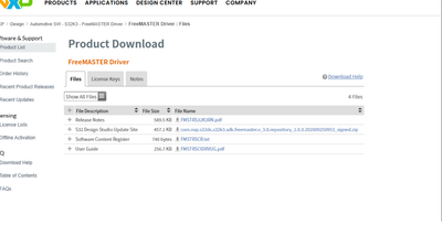

The issue is that when I initially downloaded S32 Design Studio for the S32 Platform, I indeed downloaded version 3.6.1, with the corresponding S32K3xx development package being version 3.6.0. However, when I attempted to download the S32K3 FREEMASTER serial communication driver, the system did not offer version 1.4.2—only version 1.5.0 was available. I could only download the v1.5.0 version of the S32K3 FREEMASTER serial communication driver, but this simultaneously required updating the S32K3xx development package to v3.6.4, as shown in the image below. Ultimately, my version was forced to update. So how should this issue be resolved?I want to learn the demo

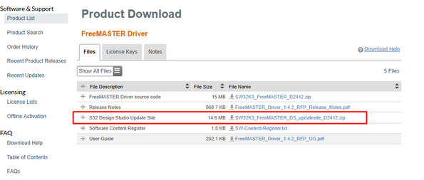

petervlna
OK, I see. Then you can do offline download and update the S3DS manually.
Here is the method:
1. download the version 1.4.2 from your NXP SW account.
Then use updatesite zip according to the guide:
https://community.nxp.com/t5/S32-Design-Studio-Knowledge-Base/HOWTO-S32-Design-Studio-Offline-Instal...
Peter

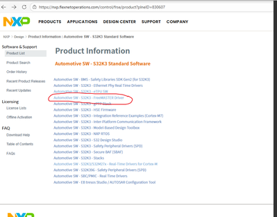

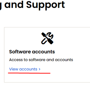

韩钦伊
_0-1765786412886.pnghello,peter,thanks  for your reply,but i cannot find this page ,can you tell me the details
969 Views

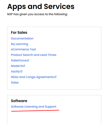

petervlna
As I shared. It is you own NXP SW account.
You will access it via NXP.com
Peter

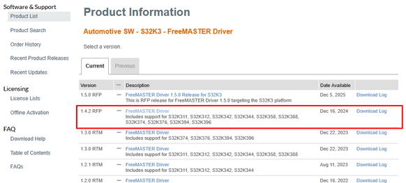

petervlna
Were you able to download if from the private message I have sent to you on community?
I have asked admin to add the right to the NXP SW account for you for the requested version 1.
4.2.
Peter
822 Views
韩钦伊
thank you,peter,i get v1.4.2,i will try

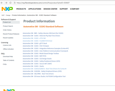

韩钦伊
hello,peter
When I clicked this link, it didn't show V1.4.2, but instead displayed what's shown in the image below.
958 Views

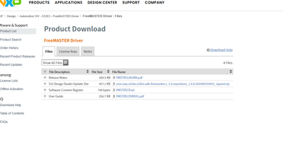

韩钦伊
hello,peter
in my account,my page is different from yours,i can not find v1.4.2
