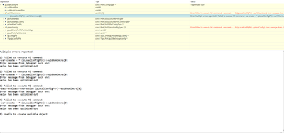

hi,
i tried to use port driver of MCAL.
but whenever i initialize the Port Driver the error was occurred and debugger be disconnected.
and F/W seems to be working.(is that reset?)
so can you find the way do not occurred the error?
chip : NXP S32K312
RTD : SW32K3_RTD4.4_R11-21_3.0.0_DS2303
DS : S32 Design Studio for S32 Platform, Version: 3.5

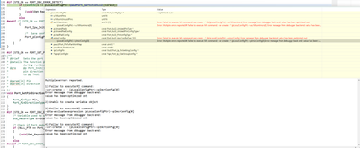

Robin_Shen
Please check whether the debug pins are still present in the UnTouchedPortPin field.
If you refer to the S32K3 PORT Driver User Manual(RTD_PORT_UM.pdf), you will find an important note:
In order to be able to use the debug capabilities, the JTAG and Reset pins need to be configured in the Port driver using mechanism B. This means that the following pins/functionalities need to be added in the UnTouchedPortPin list:
– Reset_b having PortPin Mscr set to 5 and SIUL2 Instance set to SIUL2_0
– JTAG_TMS having PortPin Mscr set to 4 and SIUL2 Instance set to SIUL2_0
– JTAG_TDO having PortPin Mscr set to 10 and SIUL2 Instance set to SIUL2_0
– JTAG_TCK having PortPin Mscr set to 68 and SIUL2 Instance set to SIUL2_0
– JTAG_TDI having PortPin Mscr set to 69 and SIUL2 Instance set to SIUL2_0
If you have modified the debug pin functionality, can you try this solution?

jwjung
thanks for reply robin.
solve the error and confirm the User Manual for RTD Port Driver.
thank you.
