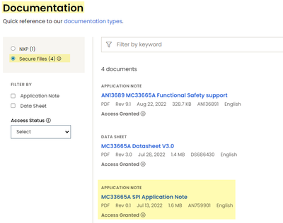

For further information, I do recommend downloading the document below from your Secure Files. Note that such document is confidential and provided only with an active NDA number.

Much thanks for your help. This MC33665A SPI application note you recommend is really useful.
