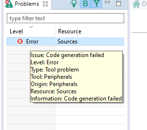

rak14
Hi @Nhi_Nguyen,
In the lwip_s32k148 example only this much is there no stack code or nothing present I tried to generate using code generator but after that also no code were present it's showing:
Issue: Code generation failed
Level: Error
Type: Tool problem
Tool: Peripherals
Origin: Peripherals
Resource: Sources
Information: Code generation failed
Rak

20,884件の閲覧回数
Nhi_Nguyen
Hi @rak14 ,
Maybe this came from your tool version. But from my point of view, there was no error that was in Problem view showed, so, no problem. In my site, I got same issue, but I was still generate code normally. Just ensure that you installed all packages that required.
Nhi
