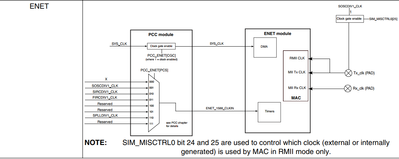

How did you configure Clock for TX_CLK and RX_CLK? and Port?
Did you try to measure signal at TX_CLK and RX_CLK? you're configuring MII 100 Mbps, so 2 these signals need to provide from external clock source is 25MHz.
Because ETH driver didn't receive message, so did you try to measure signal on both 4 Tx and RX data pins when you transmit/receive message to avoid interrupt by configuring or signal on board?

We are giving the Clock to the TX_CLK & TR_CLK from PHY (to the PHY from external crystal) with 25MHz clock for MII 100Mbps mode.
We can't measure the signals of 4 TX & RX pins when it hangs right? Because we'll be not knowing when it will hangs.

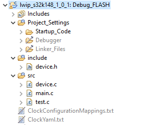

rak14
Hi @Nhi_Nguyen,
In the lwip_s32k148 example only this much is there no stack code or nothing present I tried to generate using code generator but after that also no code were present it's showing:
Issue: Code generation failed
Level: Error
Type: Tool problem
Tool: Peripherals
Origin: Peripherals
Resource: Sources
Information: Code generation failed
Rak

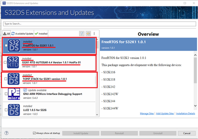

I tried to install 3 packages include:
You can check packages updated by:
I can generate the example without error:
I attached release note that you can refer to see how to install packages.
Nhi
