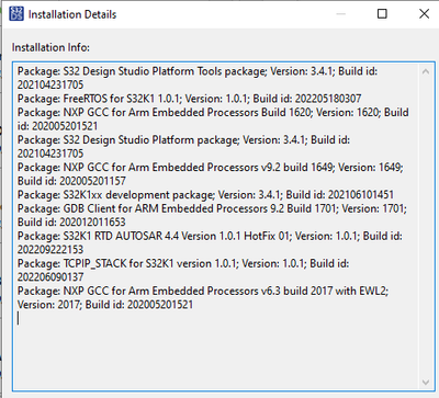

rak14
Hi @Nhi_Nguyen ,
This are the packages I've installed :
But still in peripheral it's showing error.
Rak

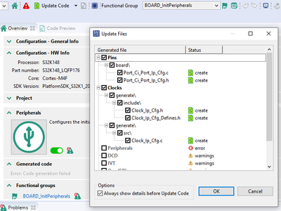

rak14
Hi @Nhi_Nguyen ,
Yes, I'm able to see the update code but in the peripherals it's showing error:
Rak
9,330 Views

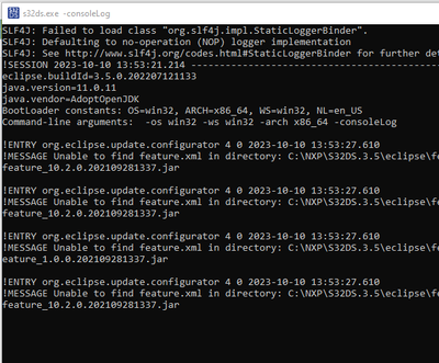

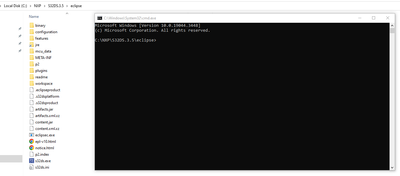

Nhi_Nguyen
Hi @rak14 ,
You can try to run this command:
go to where install ds ->eclipse-> open cmd
Then launch this command: s32ds.exe -consoleLog
Read log
Maybe you will find any error.
I attached the project that I compiled successful.
Nhi
