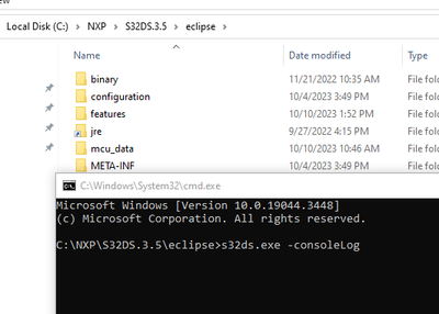

Nhi_Nguyen
Hi @rak14 ,
You can try to run this command:
go to where install ds ->eclipse-> open cmd
Then launch this command: s32ds.exe -consoleLog
Read log
Maybe you will find any error.
I attached the project that I compiled successful.
Nhi
