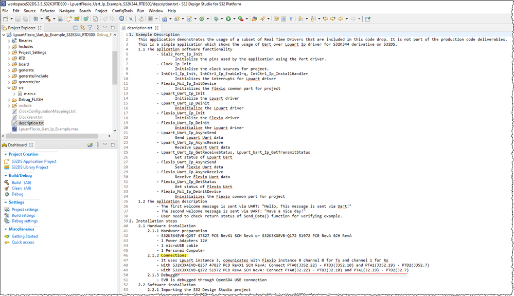

Robin_Shen
Did you modify the LpuartFlexio_Uart_Ip_Example_S32K344 example? If not, did you follow the 2.1.2 Connections of description.txt? With S32K3XXEVB-Q172 51972 PCB RevA SCH RevA: Connect PTA0(J2.22) - PTD3(J2.10) and PTA1(J2.19) - PTD2(J2.7)

Robin_Shen
Sorry. The Connections in description.txt is wrong. This project actually uses these pins:
If it still doesn't work, try updating S32K3 RTD 3.0.0 P07 and test it again.

Robin_Shen
Would you please connect PTD0(J37.3) - PTD3(J2.10) and PTD1(J37.1) - PTD2(J2.7) and test it again?
I don't have an S32k3x4EVB-Q172 development board, but when I connect the signals on S32k3x4EVB-Q257, the Flexio_Uart_Ip_AsyncSend() function returns the FLEXIO_UART_IP_STATUS_SUCCESS status.
According to description.txt, no TTL converter or Putty application is required to test this example.
