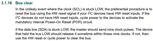

vignesh3
If the data line (SDA) is stuck LOW, the master should send nine clock pulses. The device
that held the bus LOW should release it sometime within those nine clocks. If not, then
use the HW reset or cycle power to clear the bus.
How can I send the 9 clock pulses, I am using S32K322 MC.
7,830 Views
danielmartynek
Hi @vignesh3,
The RTD I2C drivers do not have such a function.
You would need to do it using the the Port/SIUL2 drivers.
That mean you need to reconfigure the SCL pin from LPI2C to GPIO and toggle it.
Refer to in AN4803 I2C Non-Blocking Communication
There is a pseudo code that does that.
tI2C_fault I2C_Restore(void)
https://www.nxp.com/docs/en/application-note/AN4803.pdf

danielmartynek
Hello @vignesh3,
Yes, you need to reconfigure the pin to GPIO (disable LPI2C) and toggle it, the implementation is down to you.
To power cycle the I2C Slave, you have to power it down.

danielmartynek
Hi @vignesh3,
I don't think it the LPI2C Master that drives it low.
Anyway, you can simply disconnect the SDA pin from the LPI2C module in SIUL2 (in the MSCR register of the pin).
Then, the pull-up resistor should pull SDA to VDD unless it is driven by a slave device connected to the bus.
