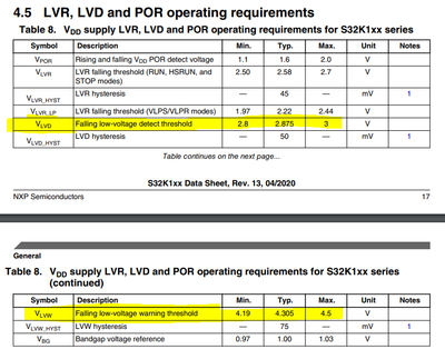

We have S32K146 & S32K148, we would like to make our customers aware when the supply voltage of our MCU is low or high.
I have informed myself about LVD system in reference manual and I have some inquiries/problems and kindly I would like to ask for your support.
1. when I provided our MCU supply voltage between V lvd threshold  2.7 and 3.0 volts, I read PMC_LVDSC1[LVDF] that its 1 when low-voltage event detected, and when I provided back above V lvd, I have read 0 again, so it was working as I expected. But is it possible that I can also configure this threshold ? for example to make it between 2.7 and 3.2 ?
2. Regarding Low Voltage Warning, I am always reading PMC_LVDSC2[LVWF] = 1 regardless of what supply voltage is provided, I tried to provide voltage of all values between 2.7 until 5 volts and it is always returning 1.
according to S32K1xx Datasheet, the threshold level for V lvw is between 4.19 and 4.5.
so why I am always getting 1 even though my internal supply is above the trip point? maybe i missed something?
I am also aware that I should acknowledge LVWACK so that I clear LVWF.

Hello Nader,
I'm sorry for the late response.
1.
Unfortunately, it is not configurable.
2.
I will need to test it, it might take some time.
3.
This is expected, the interrupt will be asserted again as the flag cannot be cleared.
You could disable the interrupt within the ISR.
4.
The POR bit would be set if the VDD voltage dropped further below the V_POR level (typ. 1.6V).
If the voltage stays above V_POR during the reset sequence, only LVD is set.
