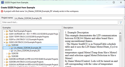

  When I used the K146 chip before, I could generate code using LinStack configuration. Now I'm using the S32K3 chip and I don't know how to generate the configuration using LinStack
1,826 Views
PetrS
there is LINStack demo example available within LINStack installation you can refer to.
So install right LINStack version depending the RTD you have installed and create new project from example. Refer LINStack user manual for more info.

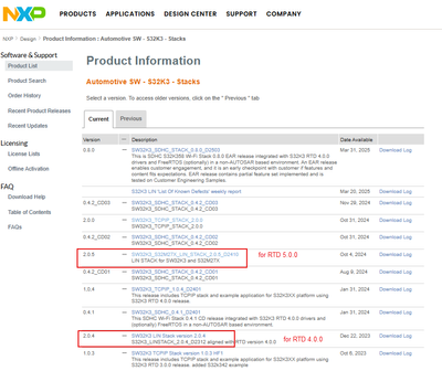

Thank you for your answer. I still have one question, which installation package should I download
1,801 Views
PetrS
depends on RTD installed, for example for latest 2 RTD versions you could have
BR, Petr
