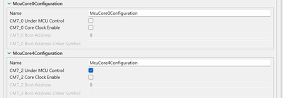

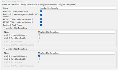

Hi :
I am interesting in dual core function based on s32k358, is there any related documents or example that I can check?
The following MCU setting is my project now, I think I use core2 only, I want to know if I want some tasks run at core1 and some run at core2, what should I do?
The other question is Can I run a project with lock-step and dual-core functions in the same time?

I still can not understand about how to set the MCAL MCU for dual-core. But I know it would be one project two folder if I want to use dual core, I want to know about the following part how to set, is this related to dual core?

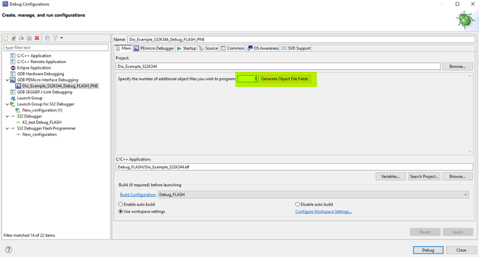

petervlna
Not personally as I work with Lauterbach and I am writing multicore scripts for such purpose.
But in S32DS is such possibility:
You can place multiple efls in the launch group
Peter

I’m using S32K358 and trying to boot only CM7_2 (Core2) without enabling CM7_0 (Core0).
However, when I disable CM7_0 and flash the application to CM7_2, the chip seems to lock up and I get “Secure Debug Access Denied”.
After I use j-link to erase, then I can access it again.
So I want to confirm:
Is it possible to run Core2 standalone, without enabling Core0?
Or is CM7_0 always required to be active first before Core2 can start properly?

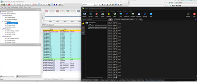

4,267件の閲覧回数
BillWen
Hi Petervina:
Thanks for your help, the following is the figure that I implement 358 tpl bringup project into Dual-core mode.
Left side fun on core0 and right side run on core2.
BR, BillWen

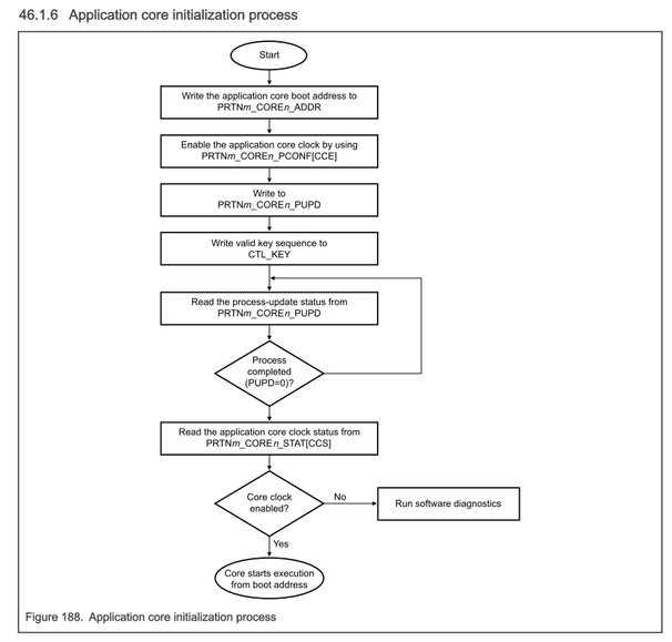

BillWen
Hi Peter:

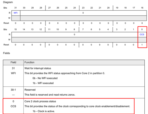

Yes, I want to start from core0 and use the following code to enable core2,
IP_MC_ME->PRTN0_CORE4_ADDR = (uint32)0x00800000;
IP_MC_ME->PRTN0_CORE4_PCONF = MC_ME_PRTN0_CORE4_PCONF_CCE_MASK;
IP_MC_ME->PRTN0_CORE4_PUPD = MC_ME_PRTN0_CORE4_PUPD_CCUPD_MASK;
IP_MC_ME->CTL_KEY = 0x5AF0U;
IP_MC_ME->CTL_KEY = 0xA50FU;
while (IP_MC_ME->PRTN0_CORE4_PUPD == 1) { };
while ((IP_MC_ME->PRTN0_CORE4_STAT & MC_ME_PRTN0_CORE4_STAT_CCS_MASK) == 0) { };
Check the clocks and if the cores are active in ME module.
I'm not sure about this, can you tell me more detailed ?
BR, BillWen

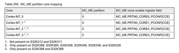

4,154件の閲覧回数
petervlna
I am not familiar with code/driver you are using and since there are only macros I cant judge.
Simple follow the RM for core enable:
petervlna_1-1745916880329.pngpetervlna_1-1745916880329.pngpetervlna_2-1745916915009.pngpetervlna_2-1745916915009.png
46.7.23 Partition 0 Core 2 Status Register (PRTN0_CORE2_STAT)

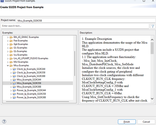

I would start from the reading of reference manual and the RTD example projects.
For example MCU module:
Well, this is application dependent.
Basically you can write simple scheduler which will execute function on selected core.
Or you can use OS, which will assign the task and resources to the core.
It really depends on how optimized you like to have the code.

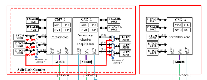

Yes, as you can see there are 3 cores. Two are lockstep and 1 separated.
