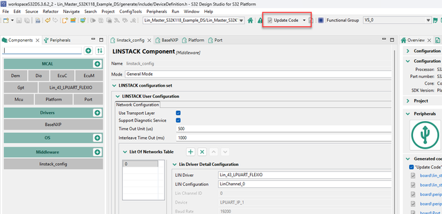

hi,
I installed S32DS V3.6.2 250529 (Update 2),  SW32K1_S32M24x_RTD_R21-11_3.0.0_D2503_DesignStudio_updatesite.zip and SW32K1_S32M24X_LIN_STACK_2.0.0_D2503_DesignStudio_updatesite.zip.
Then i import Lin_Slave_S32K118_Example_DS, we can see some head files are missing, detail please see the attachment "compiler error.txt".
I tried to search these files in "C:\NXP\S32DS.3.6.2", and added in compile path:
but still will report mcu.h -> Mcu_Cfg.h compiler "[!" error:
Q1: Please help to check is environment problem?
Q2: I try to set LIN stack configuration in S32DS, then port the LIN code to my keil compile environment, can you give some advise?

Have you try to click Update code before compile project?

I try to update the source code, then i will get error:
LIN Stack document show support S32DS V3.6, but now I use S32DS V3.6.2, so this is S32DS version problem?

Hi@LJX
Judging from the error in your screenshot, you haven't installed RTD and LIN STACK properly. Please double-check your installation.
For example, you can try opening some of the examples provided with RTD.
