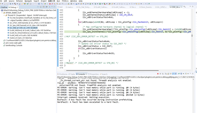

Hello NXP Team,
I'm encountering an unusual issue with our system:
  1. Normal Operation:
    • When the SBC enters sleep mode (with only 12V power remaining) and is immediately woken up (3.3V/5.0V power rails restored, ~10s wait), I2C initialization works correctly.
  2. Failure Case:
    • If the SBC sleeps for 5 minutes before waking up, the I2C initialization triggers a HardFault.
Additional Information:
  • I can connect the PE debugger to monitor the chip during the HardFault, but I'm unsure what specific debug information to capture.

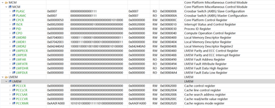

To clarify, we are not using the MPU (Memory Protection Unit). Here are some register information captured during the error occurrence: jianjie_0-1758891075801.png

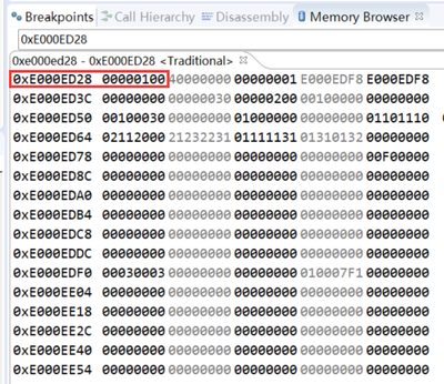

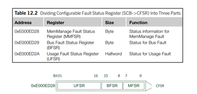

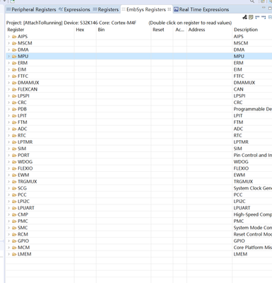

jianjie
Hello!
I couldn't find the S32_SCB module on my side, but I did see the content at address 0xE000ED28. I'd like to know what causes this exception to be triggered, and why waking up after 1-2 minutes of sleep doesn't trigger the exception, while waking up after 5 minutes does trigger it.Does this indicate that the chip is already damaged?
