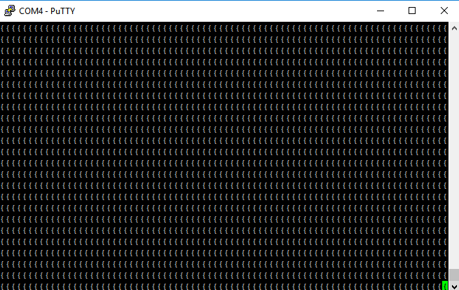

Hello
I want to send int values using LPUART , I'm using the example code lpuart_echo_s32k144 and modified the main accordingly:
#include "Cpu.h"
#include "pin_mux.h"
#include "dmaController1.h"
#include "clockMan1.h"
#include "lpuart1.h"
volatile int exit_code = 0;
/* User includes (#include below this line is not maintained by Processor Expert) */
#include <string.h>
#include <stdint.h>
#include <stdbool.h>
int main(void)
int CURRENT = 123;
int buffer[5] = {CURRENT};
CLOCK_SYS_Init(g_clockManConfigsArr, CLOCK_MANAGER_CONFIG_CNT,
g_clockManCallbacksArr, CLOCK_MANAGER_CALLBACK_CNT);
CLOCK_SYS_UpdateConfiguration(0U, CLOCK_MANAGER_POLICY_AGREEMENT);
PINS_DRV_Init(NUM_OF_CONFIGURED_PINS, g_pin_mux_InitConfigArr);
LPUART_DRV_Init(INST_LPUART1, &lpuart1_State, &lpuart1_InitConfig0);
while (1)
LPUART_DRV_SendData(INST_LPUART1, (int *)buffer, strlen((int *)buffer));
All I recieve on PuTTyis the ASCII equivalent of 123 i.e '{' . What changes must be done in the function call of LPUART_DRV_SendData; so that I get the value I have sent ( i.e as 123 on PuTTy)

  Using this function , solved my issue
itoa(CURRENT, buffer, 10);
