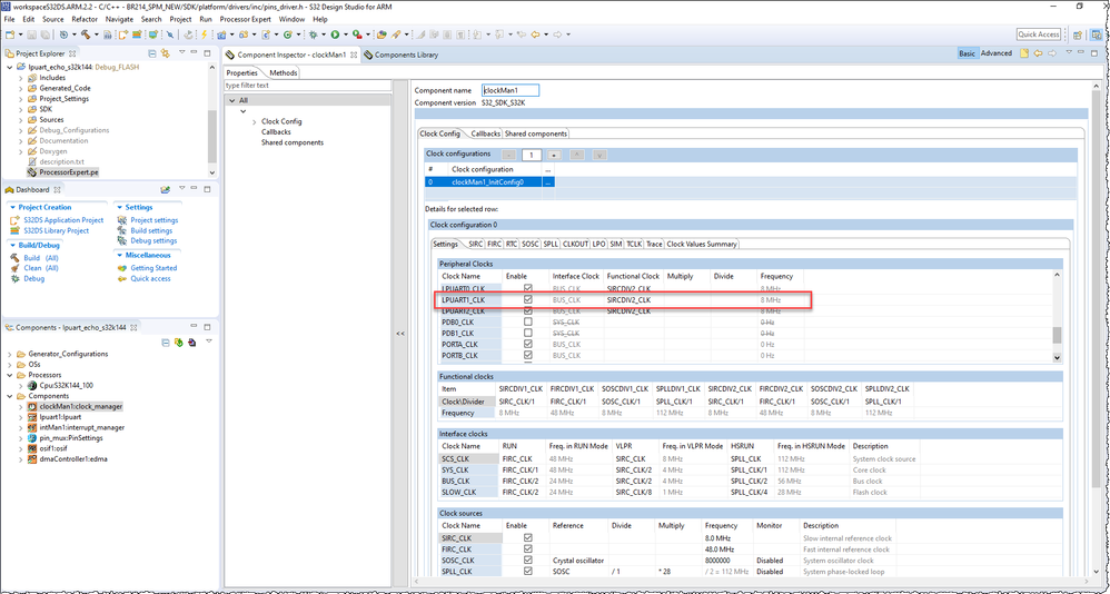

I am working on S32K144 LPUART. I want to test UART with 115200 baud rate for BLE connectivity. When configure baudrate as 115200kbps actual baud rate is 115384kbps.
When communicating only to BLE, communication is successful, once few task are added communication fails.
How to configure to 115200 exactly?

Thank you. After changing the clock for LPUART0 to SIRCDIV2_CLK, the BLE app is now connecting, but not consistently every time. It is successful 3 out of 5 times. What could be the reason? I am using LPUART1 with FIRCDIV2_CLK for USART interface, which is working fine. WIll this be affecting the behaviour of the BLE?
8,755 次查看
Robin_Shen
Please check the real baudrate of BLE.(Measure the bit width of signal sent out from BLE by using oscilloscope.)
You can adjust the baud rate of LPUART as close as possible to the baud rate of BLE.
You don't have to configure the baud rate of LPUART to 115200, just need to make the UART baud rate meet the tolerance require of BLE.
Robin

sandhyaravikuma
Thanks Robin. I measured and changed the baud rate. It is now working consistently. My problem has been solved by changing the LPUART0 clock to SIRCDIV2_CLK and by changing the Baud rate. Appreciate your help in getting it to work.

Have you try to measure the baud rate when communication fails?
Would you please tell me clock source of LPUART? The accuracy of the clock source will also affect the baud rate.
