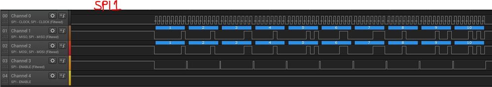

Here I have attached my code , in which SPI0 is the master and SPI1 and SPI2 are the slaves , if am communicating alone with SPI1 or SPI2 it is working fine able to send & receive data properly. but if SPI1 and SPI2 sharing the SDI & SDO, SCLK lines of SPI0 then am seeing master received data is "255".

Small observation here all the time am seeing Slave side CS pin (SPI1) is high even after SPI transaction.

Saitej
am using S32K148_SDK 3.0.0
Yes, in debug mode cross verified the TCS register it is updating as per requirement. Even in the logic analyser we can see CS is working as expected & even MOSI line also working as expected.
But MISO is line is continuously high.

danielmartynek
It seems like the slave modules do not detect the PCS.
All I see from the attachments is that the slave modules are routed to 2 PCS each in PORT.
But are the slave modules configured to the correct PCS in LPSPI?
Also, get the status of the slave transfers with LPSPI_DRV_SlaveGetTransferStatus().
