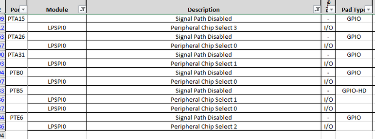

The LPSPI0 module supports only 4 PCS.
But the S32K148 MCU has 6 LPSPI0 PCS pins.
So you could use all of the PCS pins.
For example LPSPI0 PCS0 can be either PTA26 or PTB0.
The port module would need to be reconfigured so that the LPSPI0 module can control the correct pin before a transfer is triggered.
We don't have such an example though.
