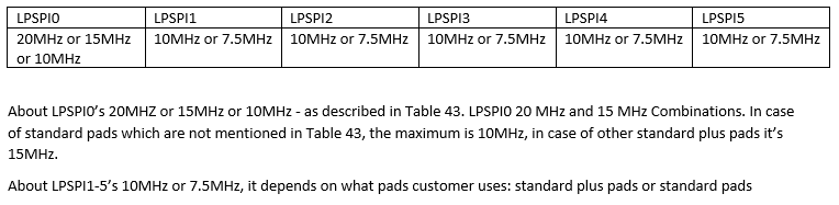

What is the S32K344 LPSPI maximum supported bus rate on Standard Pads and Standard Plus Pads?

Hi Pouya,
This information is not clear enough in the current Rev.4 version of Data Sheet and Reference Manual. Please see the pictures below:
