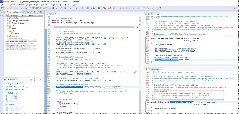

Please refer to the description of LPIT_StartTimerChannels to check whether the input parameters(mask) of LPIT_DRV_StartTimerChannels match the description.

You don't need to call LPIT_DRV_Init in each channel initializes function.
Please check if each channel is able to run.
