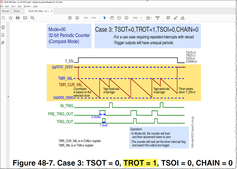

I am generating a 10ms ISR using LPIT.
Also I am capturing a PWM signal in FTM0 channel. I want to reset the LPIT counter whenever an edge is detected in FTM0 channel.
Could you please tell me how can I reset the LPIT counter.
Thanks in Advance.
1 解答
3,634 次查看
Robin_Shen

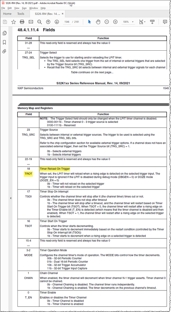

When set TROT, the LPIT timer will reload when a rising edge is detected on the selected trigger input.
Figure 48-7. Case 3 TSOT 0 TROT 1 TSOI 0 CHAIN 0.pngFigure 48-7. Case 3 TSOT 0 TROT 1 TSOI 0 CHAIN 0.png
But the trigger source from FlexTimer are FTMx_INIT_TRIG and FTMx_EXT_TRIG
FTMx_INIT_TRIG: counter initialization trigger
FTMx_EXT_TRIG: channel match trigger
These two trigger source from FlexTimer don’t seem to be suitable for your application.

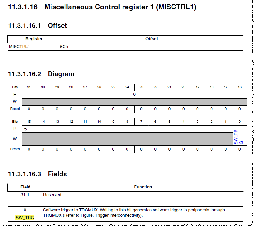

Writing to MISCTRL1[SW_TRG] generates software trigger to peripherals through TRGMUX.
But seems using another FTM may more easier: configure another FTM works as simple timer.
Or using LPTMR, software reset the counter in ISR.
