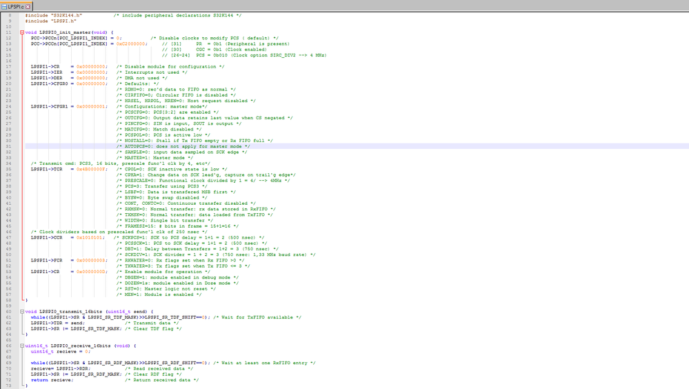

I want to setup the LPI2C module with 1MBit/s baudrate, then just send a command to a slave
and wait till it sends data back...
No SDK example
something like this example about the LPSPI module:
