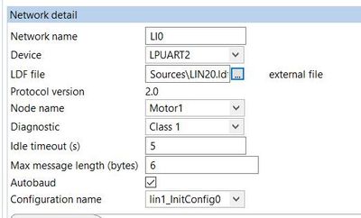

Hi All,
two questions:
NXP's LIN Stack supports specification v.2.2, V2.1, 1.3  and J2602 1.1.0.
- Are there any issues in using ldf files for v2.0?
- Is it possible to edit the lin stack for specification 2.0?
- Is there an implementation of NXP LIN stack for v2.0?
as a side note, we have following issue importing the ldf file:
Description Resource Path Location Type
(Error: line: 468 "FlashRequest"- Multi definitions for Diagnostic Master Request Schedule table.): Please change tab "LIN description file", change the file in "LDF file name" to Sources\Test.ldf for more inforfation (LDF file) can_pal_s32k146 lin_cfg/LDF file Processor Expert Problem
Any hint on this topic?
K.R.
L.T.

please refer below answer from Stack SW team...
[A] As far as I know, we can generate the configuration files normally.
[A] Yes. The lin v2.0 is already supported from SDK K1 RTM 3.0.3 and above. Please check your SDK release version to make sure you are using the correct version.
(Error: ....
[A] It seems you have defined with multi Diagnostic Master request schedule table as below.
Currently, we do not support defined with multi diagnostic master request schedule table. So, please make sure we have only one schedule.
I also share with you the ldf file example(Attached) which is supported the lin v2.0. You can refer it to more detail. (remove txt extension)
