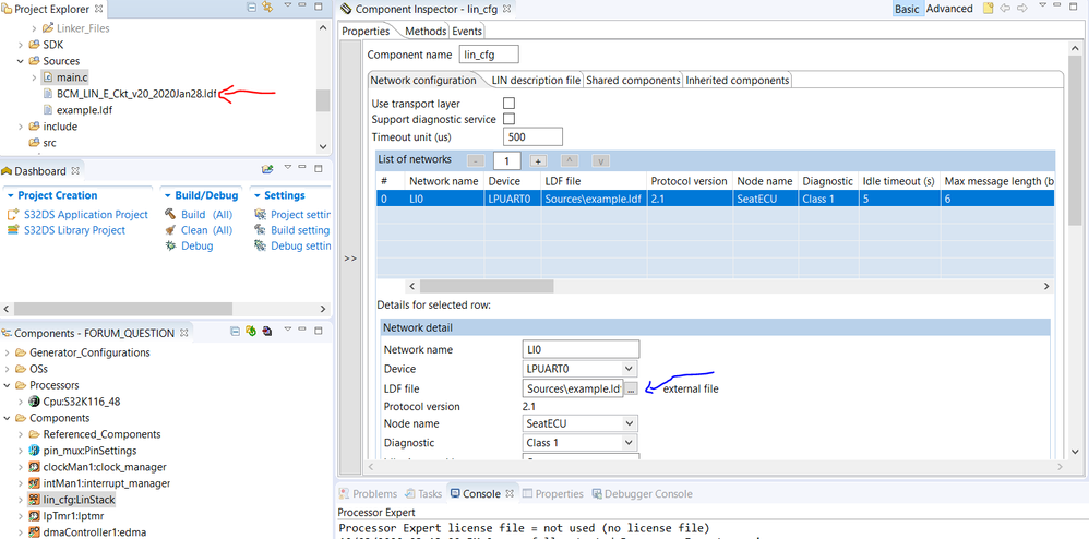

I'm trying to use the S32DS to create a new application project using the Lin Stack. However, I want to use a .ldf that I already have. When I try that, I get the following message:
After this, my only option left is to let the S32DS rewrite my .ldf as if it was blank, and try to recreate my ldf through the component inspector, configuring each signal and message.
Basically, as I understand, S32DS is working as follows: .ldf is configured in the component inspector, then it rewrites the .ldf, and then the corresponding code is generated.
Is there a way to make it work such that: existing .ldf is imported, then that .ldf is used to configure the component inpector, and then the corresponding code is generated?

Sure. What I do is: based on the lin_slave_s32k1xx example , I'm creating a new application project on S32DS.  On the components library tab, I add to my project the components which are used in the example and that are not included by default (linStack, lptmr, dma).
After this, I use the component inspector to check and try to configure the component LinStack. Although my previously created .ldf file is found by the software (red arrow on the image below), trying to actually change the pre-loaded .ldf file is not possible. Trying to change the .ldf using the section pointed by the blue arrow on the image doesn't show my .ldf, an when I try to manually add the path to my file (changing only the name of the file, from: Sources\example.ldf to: Sources\MyFileName.ldf) I get the message shown in my question.

  1. How to parse an existing ldf file.
  • You can try to duplicate the example.ldf file in the project and then rename it (as I did below).
  • Refresh the project.
  • You can see the new file as number 1 on the image below. Click on number 2, you will have a new window as number 3 and then you can select the ldf file you need.pastedImage_7.png
  1. I have another way that you can try to update the content of your ldf file to the existing ldf file.
  • Open the existing ldf file in your project and update this file by your ldf file.
  • Refresh your project.
  • Go to “LIN description file” on S32DS, select your file and click “Reload” to update the new content of file on S32SDK.
