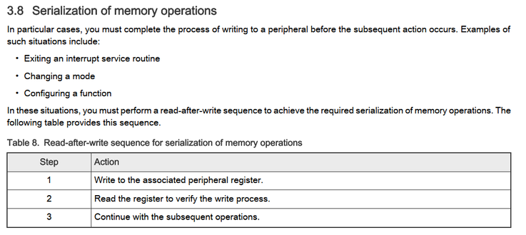

Hi @dongxun,
You're currently using an outdated version of the RTD. Please refer to the release notes for each version, which include detailed lists of Known Issues and Changes..
Consider the following:
  1. Ensure the LPUART interrupt is not being masked or delayed by higher-priority ISRs. If possible, assign the highest priority to the LPUART interrupt to guarantee timely handling.
  2. Implement debug logging around the LIN ISR and state transitions. Compare logs from successful and failed transmissions to identify anomalies or timing inconsistencies.
  3. Capture the values of key LPUART registers (e.g., STAT, CTRL, BAUD) during failure conditions to detect stuck flags or misconfigurations.
  4. Test with a reduced LIN schedule (e.g., only PID 0x10) to isolate timing-related issues and simplify debugging.
  5. Stack Integrity Check
    Investigate potential stack overflow issues: Monitor the stack pointer during runtime, Initialize SRAM with a known pattern at startup to detect overflows, consider increasing the stack size.
  6. Read-After-Write Serialization
    Apply read-after-write techniques to ensure register writes are properly completed and synchronized, especially in critical peripheral configurations.
在原帖中查看解决方案

5,856 次查看
dongxun
Dear Team,
I am writing to report the root cause and resolution of a recurring LIN communication failure observed during data transmission. After thorough investigation, the issue was traced to the ​​LPUART peripheral's status register (STAT)​​. Specifically, the ​​Overrun Error (OR) bit​​ was consistently set in cases where the Protocol Identifier (PID) failed to transmit. This flag indicates that newly received data arrived before the previous data could be processed by the interrupt service routine (ISR), resulting in data loss and communication halts.
To resolve this:
  1. ​​Immediate Mitigation​​: I cleared the OR bit in the STAT register, which restored normal LIN communication immediately.
  2. ​​Root Cause Analysis​​: I suspect that the LIN data processing ISR (​​LPUARTLIN-RXTx_IRQ​​) was interrupted by higher-priority interrupts entering critical sections. This caused delays in ISR execution, leading to buffer overrun conditions.
  3. ​​Corrective Action​​: The priority of LPUARTLIN-RXTx_IRQ was elevated to minimize preemption risks. Subsequent stress testing (continuous master-slave communication for >10 hours) confirmed stability under extended operation.
Request for Feedback
While the current solution is effective, I welcome suggestions for further optimizations, such as:
  • Implementing ​​hardware flow control​​ (if supported by the LPUART peripheral) to prevent overruns.
  • Adding ​​buffer occupancy checks​​ in the ISR to proactively clear data before overflow occurs.
  • Exploring ​​DMA-based data transfer​​ to reduce CPU intervention and interrupt latency
Please share your insights on enhancing this approach.

Hi @dongxun,
Thanks for the detailed analysis.
Based on the behavior observed, I don't believe this stems from a software driver bug or a hardware fault in the UART module. Instead, it aligns with typical embedded system behavior under interrupt-heavy conditions.
The root cause appears to be ISR preemption, where the LIN RX/TX interrupt was delayed due to higher-priority interrupts, leading to a buffer overrun (OR bit set in the STAT register).
The issue was effectively resolved by raising the priority of the LPUARTLIN-RXTx_IRQ, which prevented further preemption and restored stable communication.
This kind of mitigation is a good example of how interrupt prioritization can impact real-time communication reliability.

Aoyng
QQ截图20260514110755.pngQQ截图20260514110934.pngOK, thank you for your suggestion. I am using the S32K314 chip. According to the official documentation, I found that the size of the LPUART receive buffer for this chip is 4 bytes. May I understand that when the received data exceeds 4 bytes, an overflow interrupt will be triggered and it needs to be cleared at this time? Can I change the size of the receive buffer? The information I obtained from the above picture is that the default size of the receive buffer is currently 1 byte, but it was initially mentioned as 4 bytes. I am a bit confused about this. Do you have any understanding?
