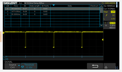

The MCU (S32K344) acts as a LIN Master. Inside ldf file three frames are declared (0x27, 0x28, 0x29), each frame hast the same structure ( getting values from temperaturre sensors)
This works fine, please see following screenshot (right now no slave is responding to the frames)
As soon as the slaves are responding to the Frames, i see a strange behaviour.
If only one slave is active (doesn't matter which one), everything is fine. The data are refreshed periodically inside the MCU. I observe the g_lin_frame_data_buffer and also the application variables.
If slave1 and slave2 are active, slave1 is behaving fine, slave2 does not refresh data. Remember, running each slave alone does work fine.
if all three slaves are active, no slave does refresh data.
But, using an oscilloscope and decoding the frames with it, shows that the data on the physical LIN BUS seems to be fine.

DirkG
Dear Daniel,
i have found the issue.
l_sch_tick() was called periodically every 10ms ( time base is also 10ms within ldf file ).
But lin_dat_timeout_service() was also called every 10ms. After changing the periodicity of lin_dat_timeout_service() to 1ms, everything has been fine.
Now im able to receive all three frames fro the slaves.
Thanks a lot for your support !!!
Best Regards
Dirk

3,652件の閲覧回数
DirkG
Hello Daniel,
thanks for your fast response.
I have checked the CRC data of all three farmes, it is correct.
See Oszi screenshot and results from "online LIN CRC calculator".
The Lin Signal looks also ok to me, here is a screenshot with onyl 0x27 active.
and also a "zoom screenshot" to frame 0x27 only.
The behaviour is still the same.
Best Regards
Dirk
