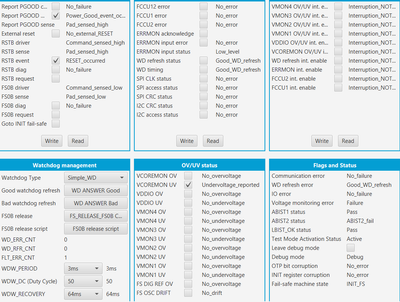

yavuzklcc
Fault screen
9,581 Views
yavuzklcc
When i send FS_OVUVREG_STATUS message (VCOREMON_UV bit is 1) ,under voltage fault is fixed,but abıst2 fault continue.

guoweisun
If fixed the Vcore UV issue,without other issue the ABIST2 will PASS.
9,541 Views
yavuzklcc
Thanks for answer.
Yes,but VCore UV issue dont fixed.What could be the source of the problem ?

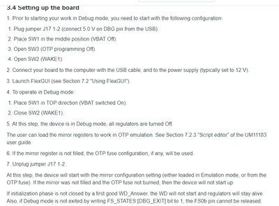

 At the same time, I apply these steps exactly. But when I send the message to exit DEBUG mode,
1-) all regulators power on and the
2-)all regulators power off and RESET pin blinks 3 times.
This cycle continues.Something seems to be going wrong.
Iam beginner, i will be glad if you help

guoweisun
Please follow up the app note for operating this SBC step by step.
Better for your test used the programmed chip by NXP you can order this part instead of blank part OTP by yourself.
After familiar with EVB then you can do OTP by yourself.

yavuzklcc
After opening the card I only see the VCORE UV issue.

guoweisun
Or can you give some picture for your error?

yavuzklcc
Yes.SBC stuck in ABIST2 phase.When i sent FS_OVUVREG_STATUS (VCOREMON bits is 1),under voltage fault is fixed ,but ABIST2 fault still continue.i will share you picture fault screen.
