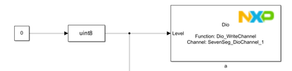

I wonder if it's possible to configure J8 debug header to GPIO for an S32K358 BMU. I tried it already, from PTD1 to PTE8, but I didn't get any voltage out.
Neither digital 0 nor 1 worked, despite the program being built and uploaded successfully.
S32CT mex file is attached.
Any suggestions?

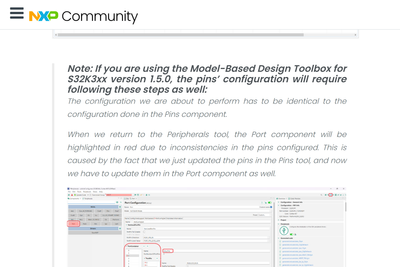

Thank you for the suggestion! I forgot to mention that I'm using 1.4.0 version of the MBDT, and according to this revised document, we don't need to configure the Port for 1.4.0. Is that true? I was following the tutorial there.

I am not very familiar with how MDBT tools work, but it is necessary to use the PORT driver to configure the pins and specify how the pin will behave electrically and functionally. A good reference to understand the connection between the Port and Dio drivers can be found at the following link (even if it is for the EB Tresos configuration tool, the concepts are similar).
