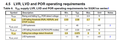

I wanted to configure Low voltage detect and low voltage reset in my S32K144 device.
Case 1: I was successfully able to generate the interrupt on LVDF when LVDIE is set in LVDSC1. The breakpoint hits the ISR when I reduce the voltage on the supply less than VLVD 2.875V .
/***********Code ***********/
IP_PMC->LVDSC1 |= PMC_LVDSC1_LVDIE_MASK; /* Enable Low Voltage Detect Interrupt */
Case2: I enabled both LVDIE and LVDRE at the same time. But with this configuration when I reduce the voltage on the supply less than VLVD 2.875V the debugger connection is lost which means the controller has reset and I have a UART print statement based on reset reason due to LVD.
IP_PMC->LVDSC1 |= (PMC_LVDSC1_LVDRE_MASK | /* Enable Low Voltage Reset */
                                             PMC_LVDSC1_LVDIE_MASK); /* Enable Low Voltage Detect Interrupt */
But according to the datasheet typical VLVD = 2.875V and VLVR = 2.58V
Can anyone tell me is this a expected behavior?

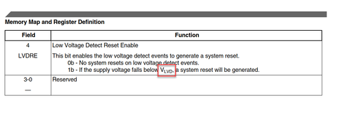

davidtosenovjan
If you have set LVDRE (as you have) then reset is triggered below V_lvd threshold.
If LVDRE is cleared, then reset will be triggered below V_lvr threshold.
So yes, it is expected.

Thanks for your swift reply.
So I can either enable LVDRE or LVD interrupt. right ?
1,258 次查看
davidtosenovjan
Yes, correct.
