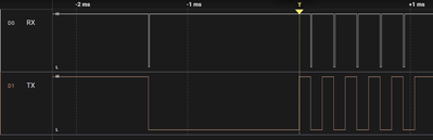

I have a S32K144EVB-Q100 board that has a MCZ33903 SBC that supports LIN. I would like to use it in an application, but I cannot seem to make the LIN example (Lin_Lpuart_MasterFrameTransfer_S32K144) work. It always ends with a timeout and the T_LinStatus remains in LIN_TX_BUSY. If I look at the LIN_TX line going to the SBC, I can see the sync and the break field get transmitted, but it never transmits the PID.
In the code, the LinCurrentState->CurrentNodeState gets set to LPUART_LIN_IP_NODE_STATE_SEND_SYNC but the Lpuart_Lin_Ip_FrameIrqHandler newer gets called afterwards.
I am assuming that no external connections are needed as there's nothing written in the description file.
Does anyone know what might be causing this?

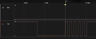

I found another one that should have TJA1027, but the problem is the same
the break and sync get sent, but nothing else and the example results in timeout.

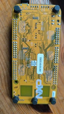

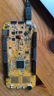

I cannot find the schematic for the SCH-29248 REV A board, but it's visible that the TJA1027 is there

PetrS
Hi Tereza,
unfortunately I do not have revA schematic, try revB, it would be similar, https://www.nxp.com/webapp/Download?colCode=S32K144EVB-SCH-29248-RB
Still this looks some very old board, probably with preproduction device. I can recommend to get some new one.
Anyway you need to power board with external 12V so TJA1027 will be powered, and be sure its /SLP pin is held high so transceiver is in Normal mode.
