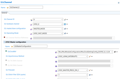

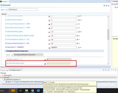

I'm facing a issue when configure I2C on Tresos tool for S32K344 microcontroller.
The current version that I'm using is: 4.0.0 HF02_D2407 (the latest version).
I configured the I2c as Fast mode, but when I try to generate the code, I get this error:
Can anyone help me with this problem? I'm not using the HighSpeedMode, so why there is this error?
Thank you,

Since you don't really need to use LPI2C_HIGHSPEED_MODE, you only need to modify the configuration so that I2cDataValidDelay meets the restrictions.
1,864 Views
Robin_Shen
Sorry for the inconvenience we bring you!
The issue is that the I2c Baud Rate field from I2cHighSpeedModeConfiguration container needs to be updated after I2c Prescaler field is updated, To fix this field, I2c Operating Mode should be set on LPI2C_HIGHSPEED_MODE and recalculate the I2c Baud Rate from this container. After I2c Baud Rate field is recalculated, I2c Operating Mode field should be switch on the desired operating mode.

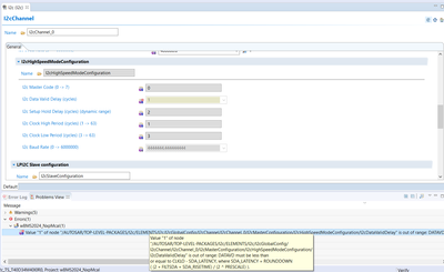

Hello @Robin_Shen ,
I did it, but I continue getting error:
Where should I recalculate this baudarte? I tried in the "Master Configuration" tab.
