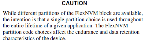

RadekS
Hi Ummer,
unfortunately, the FlexNVM isn't designed for such a scenario.
The flash configuration with partitioning settings may be erased only by mass erase command - typically with a connected debugger.
It is hard to imagine the use case where the dynamic change of EEPROM settings may be handled without potential security issues. Since EEPROM is also used for storing CSEc keys, the dynamic change of EEPROM settings is even more difficult and critical.
One of the other main reasons, why such an operation isn't allowed, is flash endurance.
The partition command initialize sector counters in FlexNVM and these counters are also used for flash aging (erase/write times slowly grow with a number of cycles for ensuring data reliability). When we do a mass erase very often, the reliability cannot be guaranteed according to values in S32K RM/DS.
