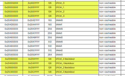

I've created a simple application to create a random number based on examples on this forum.  Unfortunately, I always receive an 'HSE_SRV_RSP_INVALID_ADDR' response.  I've tried with the Hse_Ip drivers and the hse_host.h files and get the same results each time.  Cache is disabled.
If I modify the hse demoapp to create a random number, it works. I suspect the difference lays within the linker or startup assembly file, but I'm not sure.  I've tried searching this response, but didn't find anything related in the docs or forums.

Where is your stack? Is that forced to normal SRAM or to DTCM? If it is DTCM then HSE can't see these addresses. DTCM at 0x2000_0000 is visible only for core. Other bus masters can access DTCM of a core only via backdoor address at 0x2100_0000 (in case of core 0).
So, it would be necessary to use backdoor address - add offset 0x0100_0000 to the address. Or better solution - ensure that all data objects used for communication with HSE are forced to normal SRAM.
If Autosar Crypto driver is used, there's an option to enable DTCM support. Crypto driver then automatically checks all the addresses and adds the offset if necessary. If Crypto driver is not used, it's up to user to manage that.
