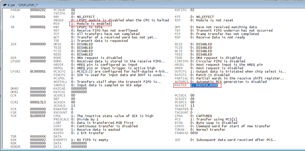

1. After called ILaS_Reset() --> LPSPI module enabled with MASTER_MODE.
< My AUTOSAR Project >
1. After called ILaS_Reset() --> LPSPI module not enabled.
2. LPSPI_1 ISR not called.
   I configured ISR but not triggered from ISELED driver.
3. Iseled_cb() not called.

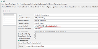

I think this issue is relating to ISR configuration or callback setting of DMA.
I compared with our example, your Callback notification of DMA are wrong, could you correct this and try again?
One other thing is make sure your Port mode is correct: PTB14 and PTB16 as per example:

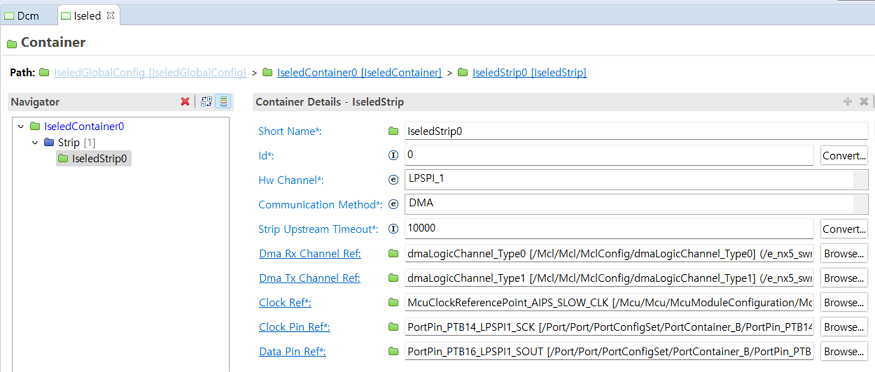

Iseled configuration is below.
It will little different with S32DS, because it used in HKMC Autosar tool.
< Iseled Module >
Generated files of ISELED module are attached.

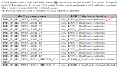

2. Could you double check the ISR configuration for LPSPI_1_Isr handler in you config? the name of ISR handler should like Integration Manual of Iseled module mentioned, and let's try to increase Isr priority of LPSPI to see if it solve issue:
3. If you're using DMA mode, let's double check for DMA complete notification in MCL module also:

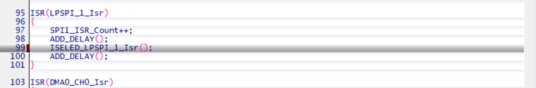

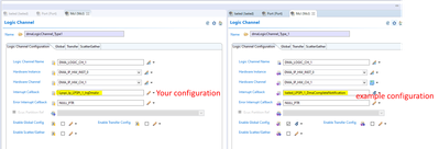

2. LPSPI_1_Isr handler is okay.
When I trigger LPSPI interrupt forced set LPSPI_1 register (TDIE), ISR called.
And it called ISELED_LPSPI_1_Isr() to ISELED library.
