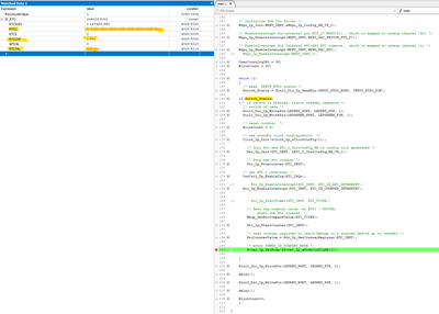

Dear NXP team,
Using S32DS IDE  ( RTD 5.0 ) for Non-AUTOSAR configuration (not EB)
I am trying to configure wake up soures as below :
1 - PTD_27 ( external pin PTD_27 WKPU[51] , wakeup channel 55)
2- Internal RTC ( RTC-API RTC timeout).
by pressing on switch at PTD_0 : the controller goes to standby mode ( Power_Ip_SetMode(pointer to standby mode)).
wake up via external source  PTD_27 ( wakeup channel 55) is working fine, and the controller wakes up as expected.
wake up via RTC is not working for some reason. even I have configured ( WKPU , POWER, RTC, Clock [2 configurations] ).
I have attached my project for you to check it ( RTD 5.0 ). please let me know if you need more infomration.

Hi Robin,
thank you for the hint.
I enabled SIRC in standby mode, and it's waking up now periodically as expected.

to add more infomration about RTC.
below is debugger screenshot for RTC registers before go to standby mode.

Robin_Shen
RTC can be the low-mode wakeup source when SIRC is configured to be enabled in standby mode.
Sirc Standby Configuration Sirc is enabled in standby mode RTC timeout wakeup.png
