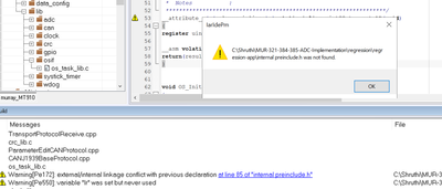

Shruthi_C
HI Lukas,
I tried the above content, but I am getting these warnings,
Warning[Pe172]: external/internal linkage conflict with previous declaration Hat line 85 of "internal preinclude.h"
Warning[Pe550]: variable "lr" was set but never used
3,819 Views

Shruthi_C
Hi Lukas,
It shows like, That file does not exists  in S32K146
Shruthi
