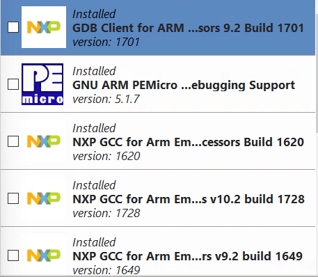

I'm having some issues after downloading DS version 3.4. This is everything I have installed:

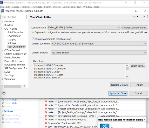

The main issue is that the GCC cannot be found in the path so the project cannot build properly. I have gcc v10.2 installed, however, there is an orphaned configuration issue:

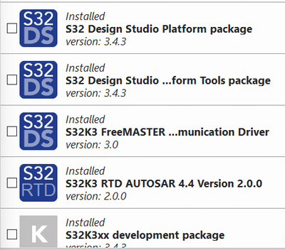

Additionally, when I try to run the Adc example project, I can't open the peripheral view and the SDK is unavailable for the project, so there are no SDKs available:

Adc_example_S32K344 seems to come from S32K3 RTD 2.0.1, but only S32K3 RTD 2.0.0 is installed in S32DS Extensions and Updates. Please offline install SW32K3_RTD_4.4_2.0.1_DS_updatesite_D2207.zip by refer to Offline Package Installation Setup. Or import Adc_example_S32K344 from S32K3 RTD 2.0.0.
(S32K3 Standard Software -> Automotive SW - S32K3 - Real-Time Drivers for Cortex-M -> S32K3 Real-Time Drivers Version 2.0.1 -> SW32K3_RTD_4.4_2.0.1_DS_updatesite_D2207.zip)
