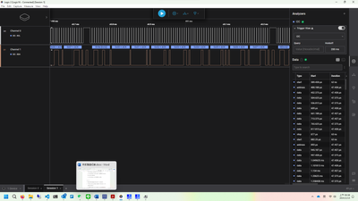

The problem: When implementing an I2C example program, we consistently observe that both the transmitted Address and Data are read as 0x00, contrary to our settings (Address: 0x32, Data: 0x00 to 0x07). We're unsure whether the I2C function is properly transferring the Address and Data we've configured into the appropriate registers, leading to incorrect output.

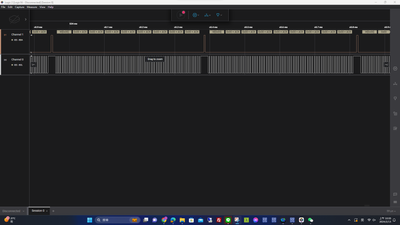

  1. I2C Example Program: We have been using the I2C example program for the S32K312 LPI2C under S32DS3.4 with RTD version 3, and it successfully transmitted data. However, after porting to S32DS3.5 with RTD version 4, we encountered the issue I previously described. Therefore, we require an I2C example program compatible with the S32K312 MCU and operable within the RTD 4.0 environment. I understand that currently, examples are only provided for derivatives K344, K358, and K396, while examples for S32K312 are available in RTD version 2.0.3. Is there any alternative or modification based on existing examples to address this issue?

Previously, we only tested whether the transmitter could correctly pass messages, so We only set the transmitter pin to pull-up. We also attempted setting all pins to pull-up, but the result remained 0x00 (as shown in Figure 1).
Figure 2 demonstrates the successful transmission we achieved using S32DS3.4 with RTD version 3.

Figure 1: S32DS3.5 with RTD version 4 (fail)
Figure 2: S32DS3.4 with RTD version 3 (success)

I have reviewed your code. I saw that you have different clock configurations in both projects. Please check this part. Also, we recommend using RTD version 3.0.0 P07 because version 4.0.0 is still under testing.
