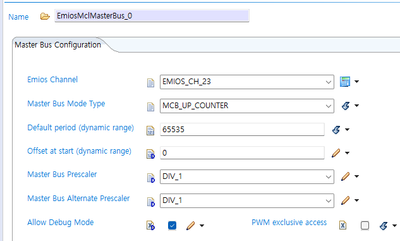

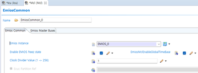

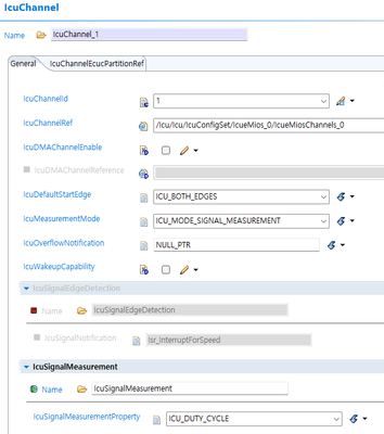

Hello NXP Team,
I’m reaching out as I am experiencing difficulties using the S32K3 eMIOS for input capture.
I would like to measure arbitrary frequencies in the range of 0-300 Hz.
Currently, the MCL-eMIOS and ICU-eMIOS settings are as shown in the attached image.
After configuring these settings:
  • I use the Icu_StartSignalMeasurement function to start the measurement.
  • Then, I retrieve the measured values using the Icu_GetDutyCycleValues function.

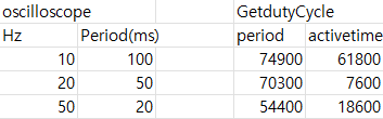

The results are as follows:
What I am curious about is that the period value for 50 Hz differs significantly from the value for 10 Hz.
Could this be due to a conversion formula I might be unaware of?

_Leo_
For PWM frequency of 50Hz with eMIOS clock frequency of 160MHz you need up to 3,200,000 ticks:
1s -> 160MHz (160,000,000 ticks)
50Hz = (1/50)s
->160,000,000 *(1/50) = 3,200,000 ticks
But the eMIOS is a 16 bits timer, which can count up to 65,535 ticks.
What you can do is try to slow down the eMIOS clock frequency.
Hope it helps you.
