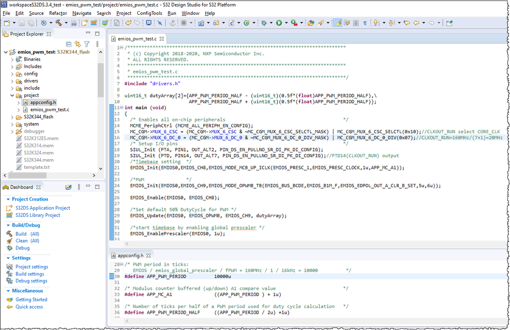

Please refer to the attached bare-metal project. But please note that my development board uses 16MHz Crystal, so the PLL configuration is different from yours. PLL output 160MHz. PTD14(CLKOUT_RUN) output 160MHz/(7+1)=20MHz. (The Pad Type of PTD14 is standard plus switching up to 25MHz). PTA1(eMIOS0_CH9) output 16kHz PWM.

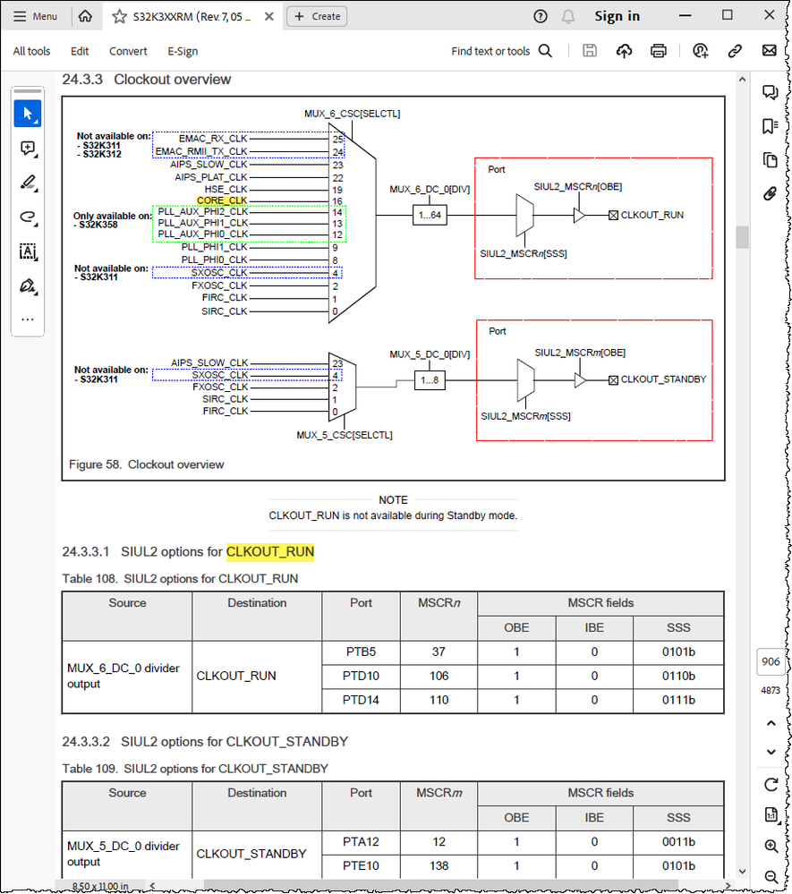

Please check the frequency of CORE_CLK by CLKOUT_RUN pin.
For the formula of PWM frequency, please refer to S32K344 hardware PWM frequency.  What value did you assign to B1?

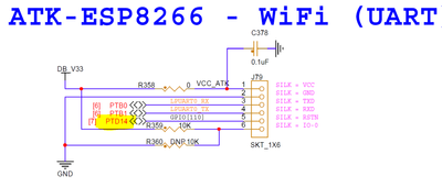

I am using S32K3-T-BOX. I checked PTD14 pin which is located on Wifi (UART) pin, and for some reason it reads zero Hz. I have MSCR[110] configured for OBE, DSE, and SSS (0x07). I have also configured MUX_6_CSC to CORE_CLK (1_0000b) and can confirm in the MUX_6_CSS that the MUX is working correctly. MUX_6_DC_0[DIV] I left at default.

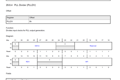

It seems like I should be able to configure correct frequency using PLLDV:

At last, we were able to get a clean 16mHz clock frequency on PLL. We changed the values around a bit for ODIV2, RDIV, and MFI bits in the PLLDV register.

I ran a few configurations; however, it seems that PTD14 on T-Box maybe not feasible for CLOCKOUT-RUN? I could not get PWM or CLOCKOUT-RUN show up on this pin. Would it be because it is tied to a reset?

Did you connect ESP8266?  If not, I don't think it was the problem.

I have not connected ESP8266. Only GPIO shows up on PTD14. On adjacent pins, I can generate PWM, but not on PTD14.
PWM frequency is a bit off. For example, when I switch to PLL(160mHz) it shows 16131kHz with 10001 period. On FIRC (48mHz), it shows 4.836kHz.
For some reason, I can't run your project directly on my environment. I used your project as a reference and set the registers. I have checked the register values, and all seems correct to me, but maybe I missed something while configuring the PWM settings? Is there a particular pin that can measure the crystal, or do I need to hold a probe to it?
