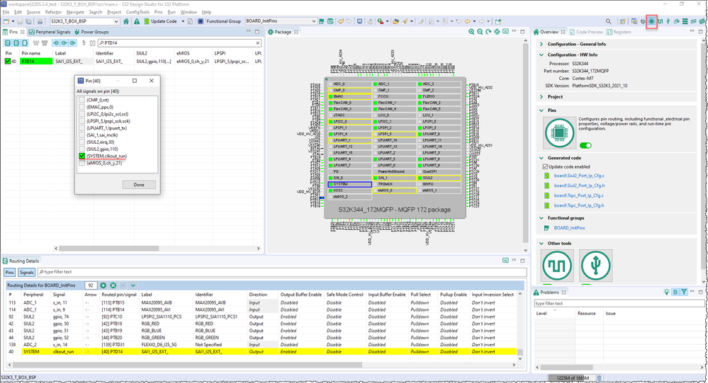

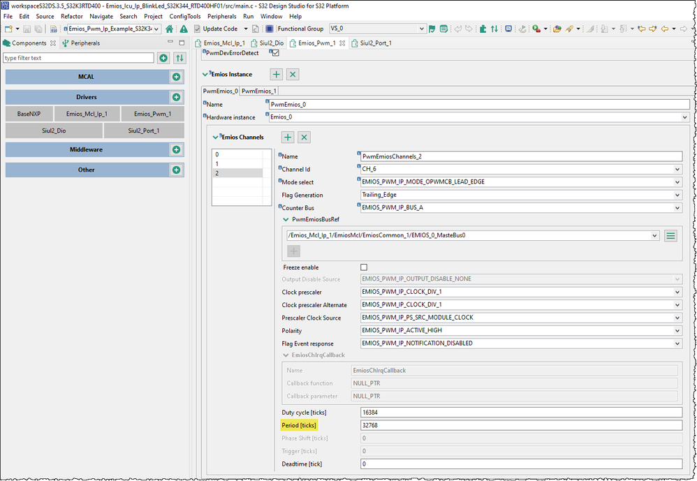

If you use S32DS+S32K3 RTD, it may be more convenient to use S32 Configuration Tool.
CLKOUT0_RUN_CLK S32K3_T_BOX_BSP.pngCLKOUT0_RUN_CLK S32K3_T_BOX_BSP.pngclkout_run PTD14 S32K3_T_BOX_BSP.pngclkout_run PTD14 S32K3_T_BOX_BSP.png
Period [ticks] Emios_Pwm S32 Configuration Tool.pngPeriod [ticks] Emios_Pwm S32 Configuration Tool.png

Hi @Robin_Shen ,
I ran a few configurations; however, it seems that PTD14 on T-Box maybe not feasible for CLOCKOUT-RUN? I could not get PWM or CLOCKOUT-RUN show up on this pin. Would it be because it is tied to a reset?
Vusal
5,085件の閲覧回数
Robin_Shen
Did you connect ESP8266?  If not, I don't think it was the problem.
Please check the values of the relevant registers mentioned before to confirm whether they are configured correctly. Also, is the PWM frequency accurate after referring to the project I gave? Have you measured the frequency of crystal and is it accurate?
