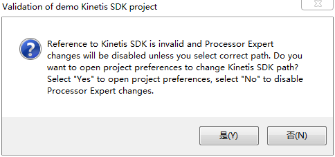

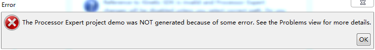

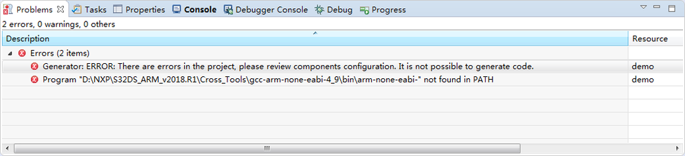

     As the title,The popup view gives an error when I import the project with S32K148.

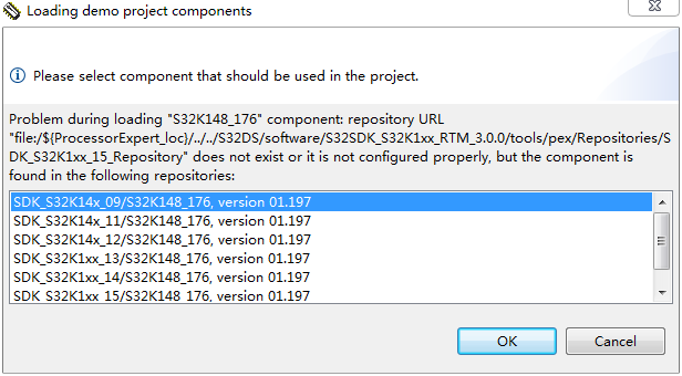

     In the first window,I chose the latest component,SDK S32K1xx 15/S32K148_176.version 01.197

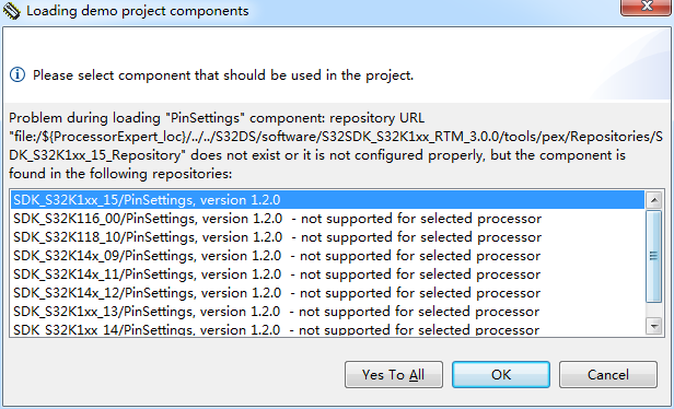

     And then,the second popup chose 'SDK_S32K1xx_15/PinSettings,version 1.2.0' and push OK.
But still keep fault
I don't know how to deal with this window to solve the problem.
Hope reply
Thanks in advance.

The reason has been found, the IDE version is not compatible.

kemingkai
This problem happen when i use S32DS 2018.R1 to import the program which create with S32DS V2.2
5,953 Views

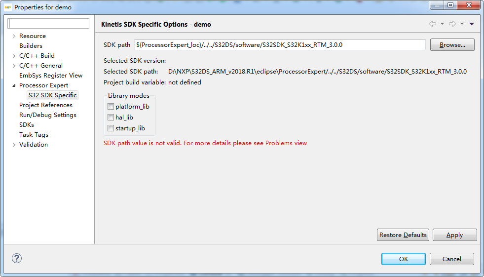

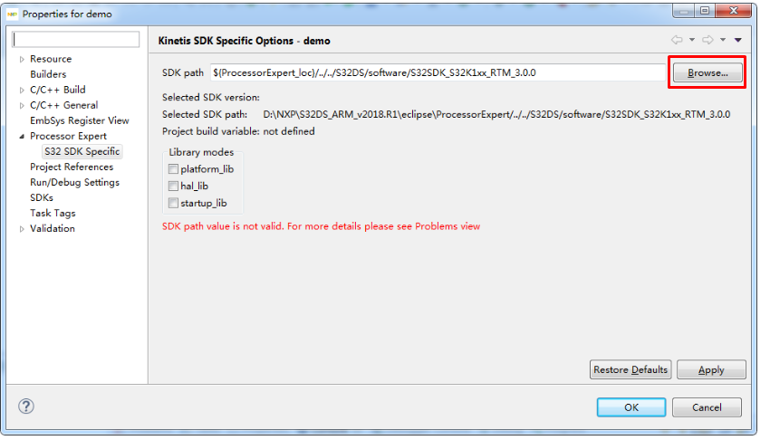

dianabatrlova
Hello Knight,
Have you tried to select correct path of SDK in ARM v2.2?
C:\NXP\S32DS_ARM_v2.2\S32DS\software\S32SDK_S32K1xx_RTM_3.0.0

kemingkai
5,953 Views
kemingkai
Description Resource Path Location Type
Generator: ERROR: There are errors in the project, please review components configuration. It is not possible to generate code. demo Code Generator Processor Expert Problem
