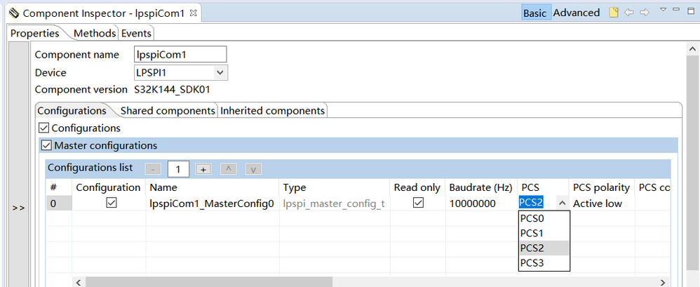

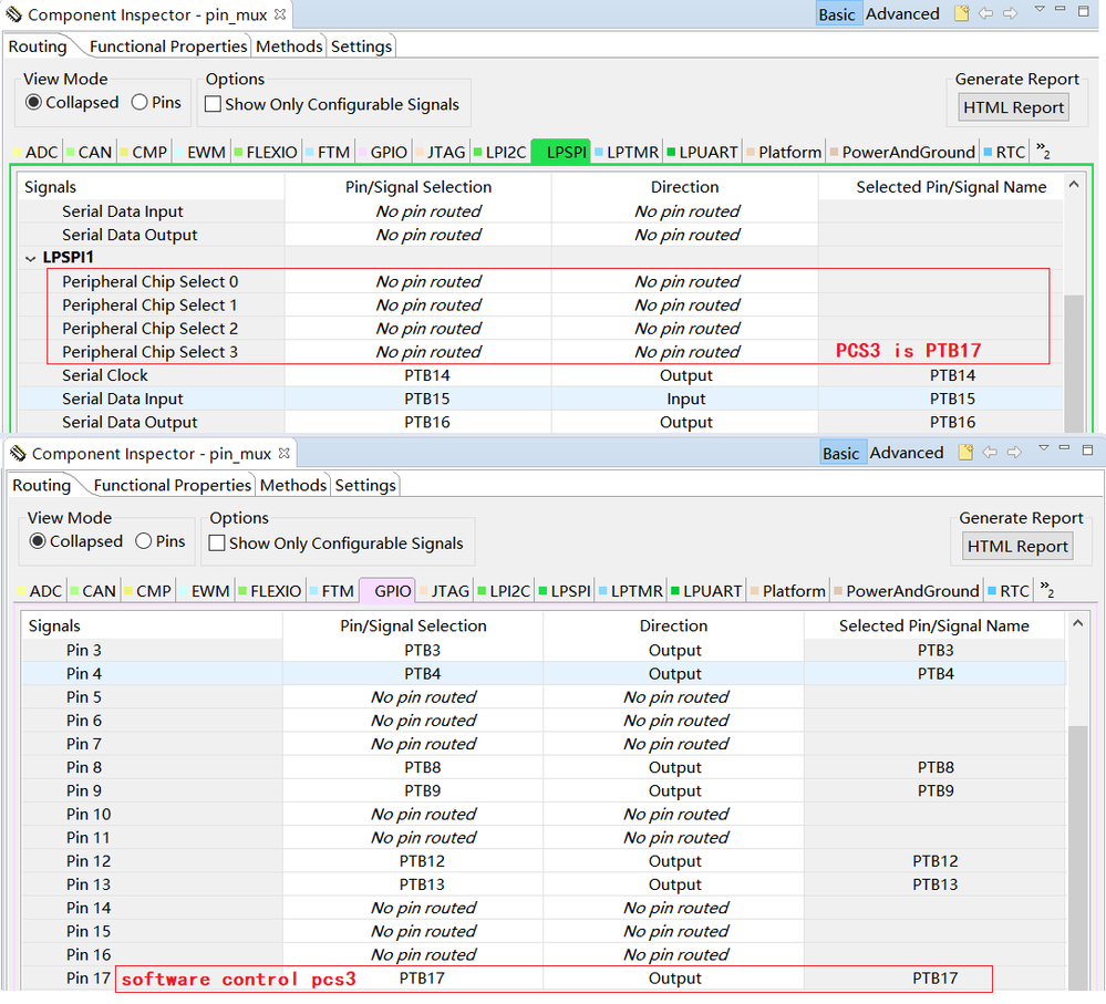

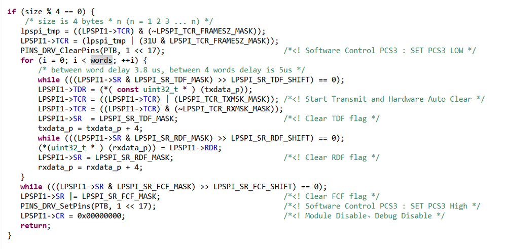

How to disable  S32K144 LPSPI  Hardware  PCS  ?
I  have use software control PCS3 ,but  I have to  select  other pcs pin  in the Processor Expert.LPSPI1_SPI_FLASH.PNGPCS_Select.png
