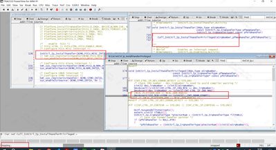

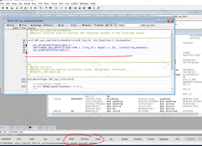

hello everyone,
   I want to load an ISR into the address of the interrupt vector table, but when I debug, I will enter a bus fault. I don't know how to solve it.

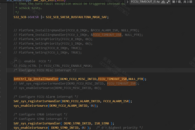

     I 'm very happy to receive your answer ,but  it seems still not work .I am working on the SPD(bist & eMcem)
    when I used this api   (IntCtrl_Ip_InstallHandler)  as the picture shows below,
when I Debug this elf,the trace32 entered to the stepping mode ,I don't know this ,if I still have some error behaviors,Please contact to me ,thanks sincerely.

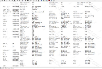

Is the vector table in SRAM?
What is the value of the VTOR register?
